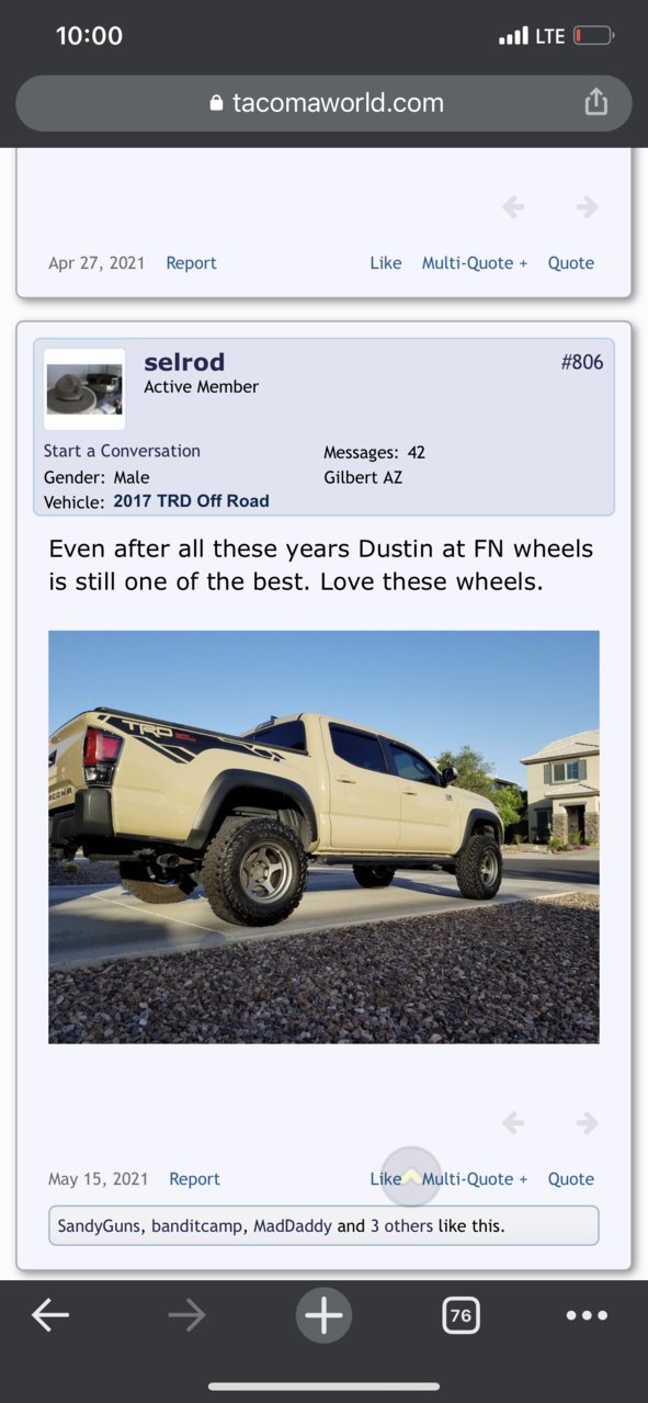

    Do you know anyone with that much offset or any pics with a similar setup? Been trying to find some.
    found this one

    Off hand I don't know the specs of those, but with your tire size unless you do like a -40 offset you should not rub.
