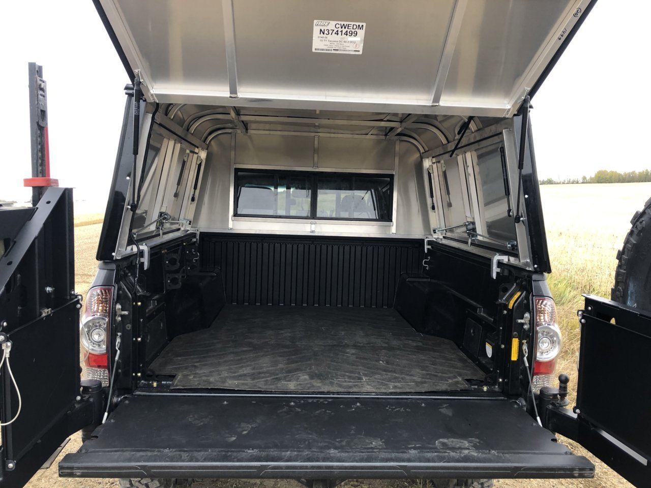

    Hey Guys I am looking at using my camper shell for camping and Would like advice on how to properly insulate this thing since its aluminum and I don't want to have condensation issues. I was thing about using poly foam board insulation for the walls and then covering it in marine/automotive carpeting. For the ribs I was thinking I would try to fill with expanding foam. Any advice is appreciated Not really sure what the best option would be for insulation but im open to ideas. Here are pics of my camper shell for a better idea.

    This is a lot like insulating a metal cargo trailer to make a DIY cargo trailer camper. They're pretty common these days and you find a lot of information insulating this kind of structure online. I'd use polyfoam board between the ribs and foil tape over the ribs to hold the foam in place and to form a vapor barrier. Pumping foam into the ribs wont help because the real problem with the ribs will be thermal bridging...ie, the outside cold will transfer through the ribs to the inside and condensation will form on the ribs. It shouldn't be too bad though. Carpet will be a nice touch.

    Have you looked into whether expanding foam might distort the aluminium ribs? I'd be careful about spraying it into tubing if it has no escape while it expands.

    Yes I was planning on using the low Expand type, like the one they use for windows so it doesn't warp any thing. @Intrepid
