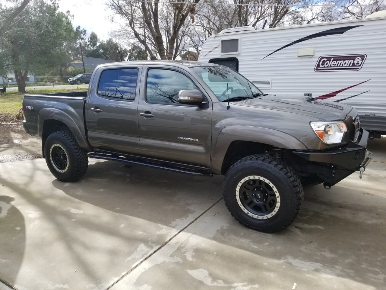

    I have only used a clay bar once on my paint, but I do regularly wax and polish. Take care of the cheap paint job on your truck and it will last a very long time. I bought my truck Oct of 2011. Check out that paint. Like glass.

    Agreed and Pyrite Mica for the win

    Nice, that looks great.

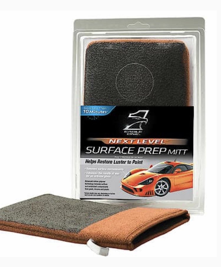

    I use the Eagle 1 Prep Mitt. Works great. For really bad contamination like visible sap, or if a vehicle hasn't been clayed in 5 years, I'll use a clay bar. But for routine detailing the prep mitt is awesome. Soooo much easier than clay.
    After washing, I get a new bucket if soapy water and just real quick go over the truck with the mitt. Results are just like clay. Easier, faster, and equally effective if you use it 2-3 times a year.
    You can usually find these at auto parts stores. Mothers makes a palm sized version that is also nice. But I like the eagle one because it's bigger and you put your hand inside. It wraps over body curves better.

    That looks interesting. Do the soapy bucket wipe down and rinse the vehicle again? Do you clean the mitt occasionally like folding the clay bar or is dunking it in the soapy bucket enough?

    Yep, clean sudsy water (after washing the truck). Dunk the mitt, do a door, rinse and agitate the pad a little bit in the bucket, then do another door. Rinse/agitate, then do half a hood, then rinse/agitate. Etc. super easy.
    Basically just like you're washing the car a second time. Don't use pressure or scrub. You're simply sliding it across the surface. That's it.
    Takes 10 mins max. You can feel the difference after a single pass of the pad. It just gets instantly more slippery. The resistance from the invisible surface build-up disappears.
    The first time I tried it, I was sold. So much easier and just as effective as clay if you're not super contaminated.
