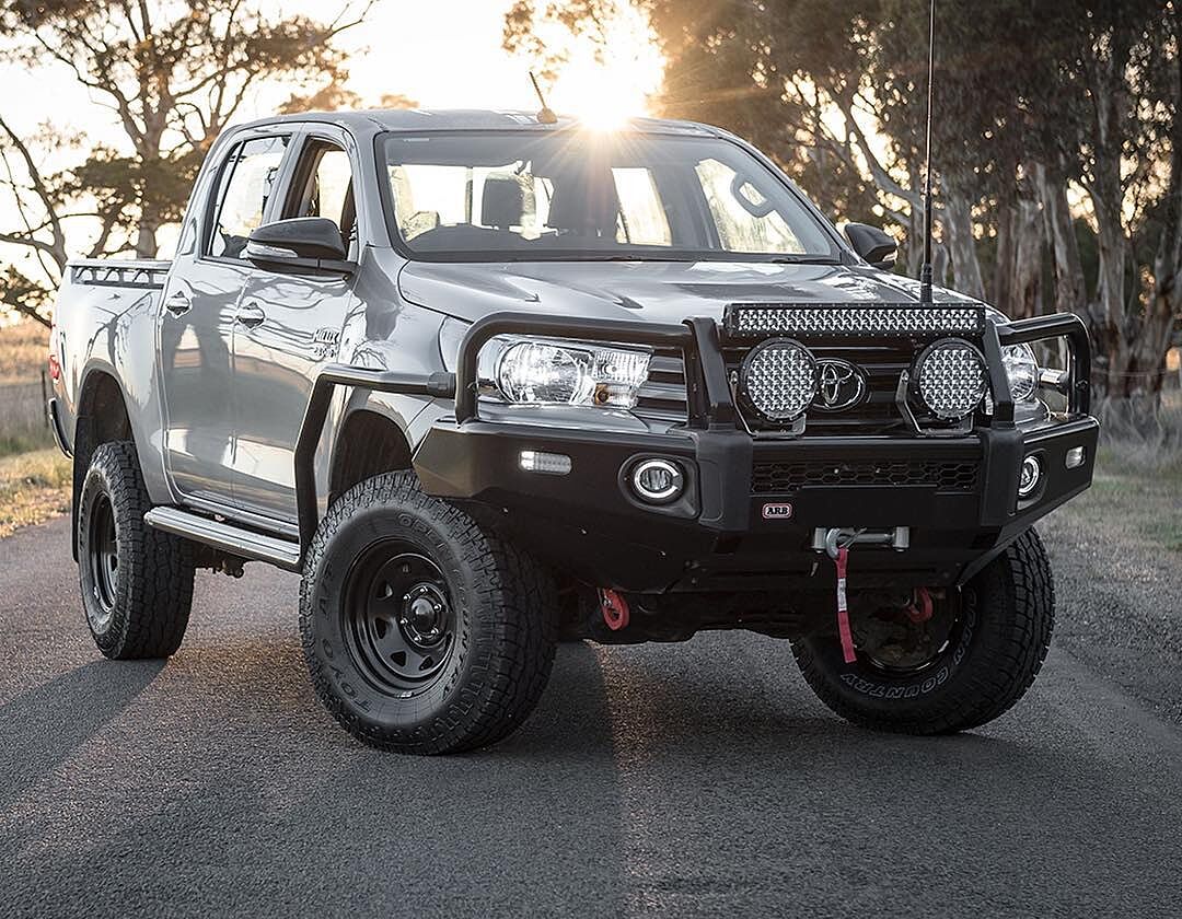

    1. Hack up the ARB plastic fog shrouds to do something like this: https://adventure-ready.com/fully-kitted-5th-gen-4runner/[​IMG]

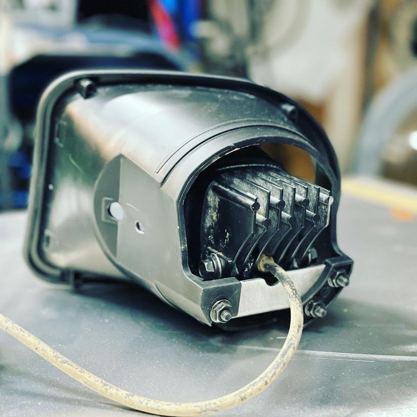

    anybody post up some pics of the back side of that?

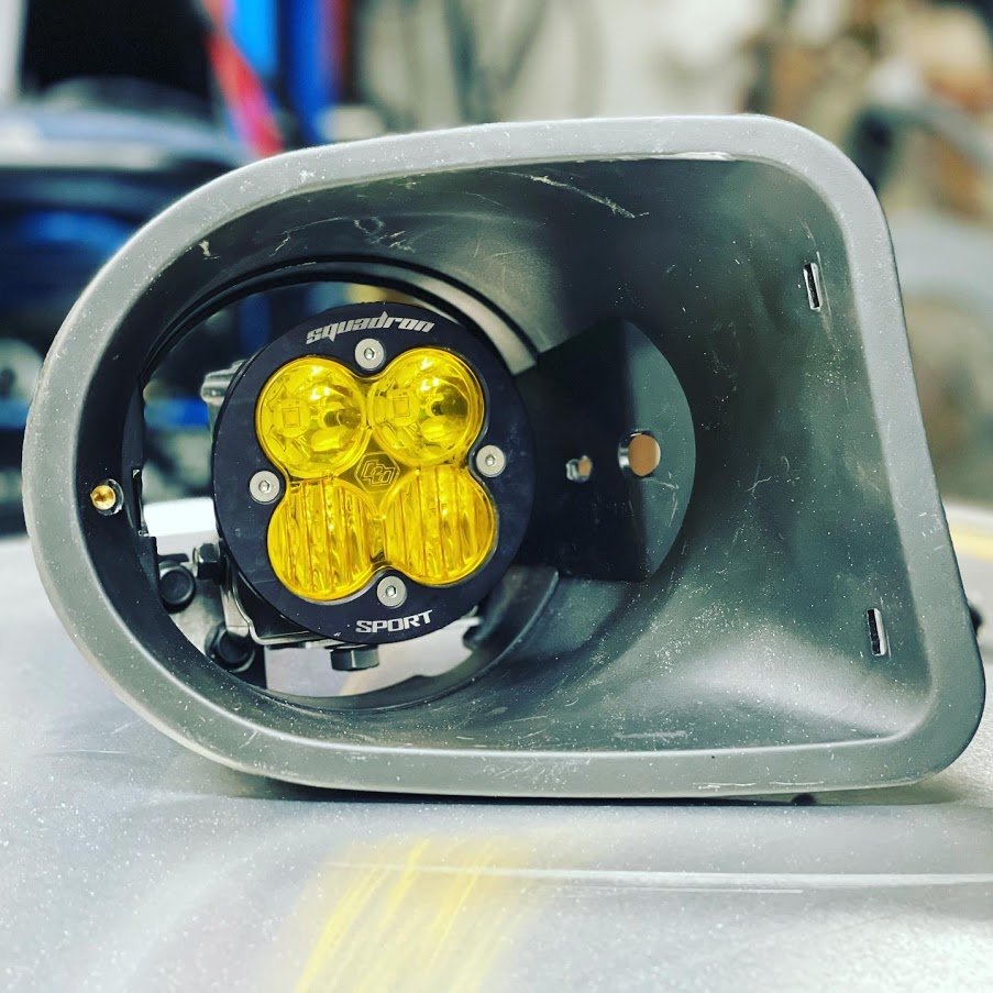

    we came up with a new bracket just for these. They work with Baja designs lights (with their normal bracket)

    when you say standard mounting bracket will work you’re referring to the main u-shaped bracket mounted to the light, correct? Just clarifying since there’s other BD fog kits that go into stock bumper fog location which I think has other metal mounting plates.

    correct, you need the normal U shaped one, not the one that comes with the toyota specific fog lights. I might start offering those brackets also if it ends up being a requirement.
