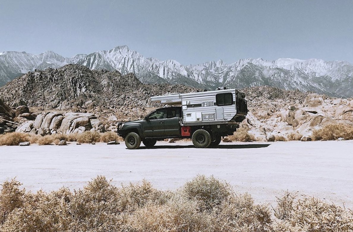

    Hey,
    Just purchased my ARB Safari Snorkel and am going to install it on Tuesday. I remember seeing somewhere on here that someone used 3M to attach the snorkel to the A pillar. They did this instead of drilling holes into and mounting that way. Curious if anyone knows that link or has insight into the pros and cons of this.
    Also, wondering if anyone has ever painted/clear coated the cut hole for rust purposes. Is this an obvious yes? My friend who is helping me install drilled holes and didn't worry about rust on his truck. So that's pretty much what I have to go off of.
    Pic for attention. :cheers:

    Yes lots of people use touch up paint to cover the exposed metal after the cut.
    Nice setup by the way! More pics please..

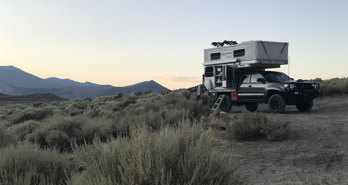

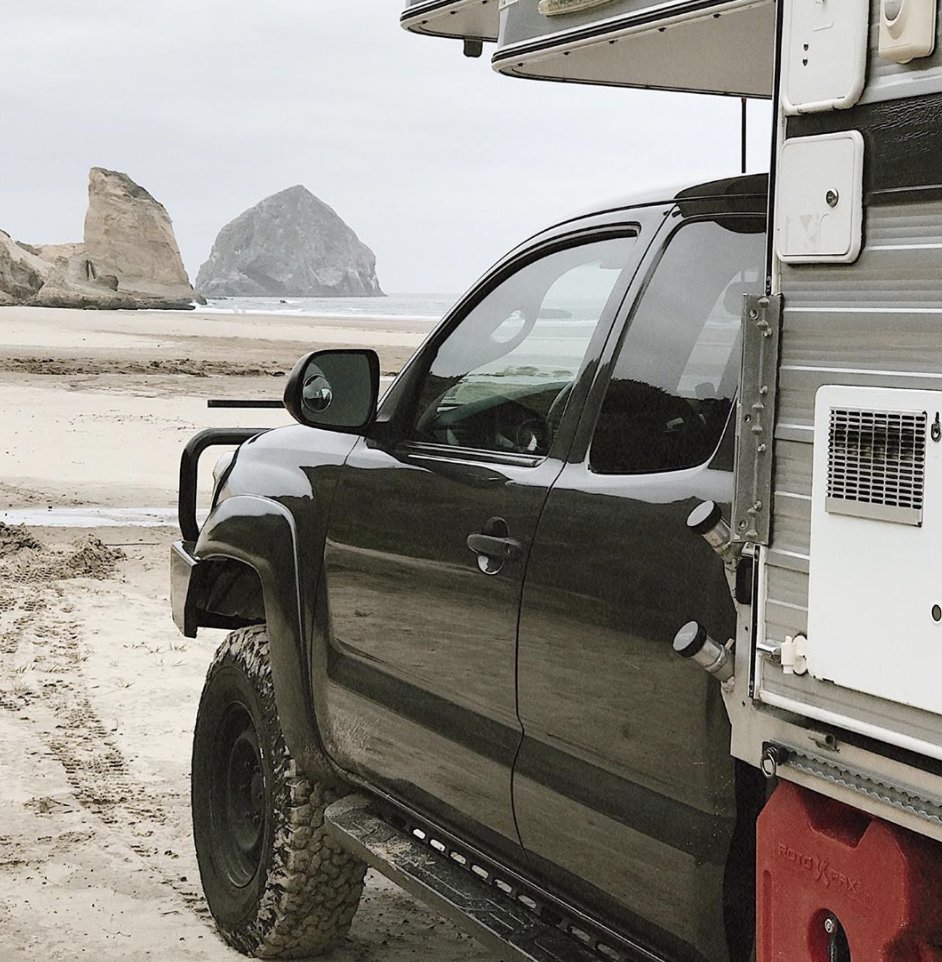

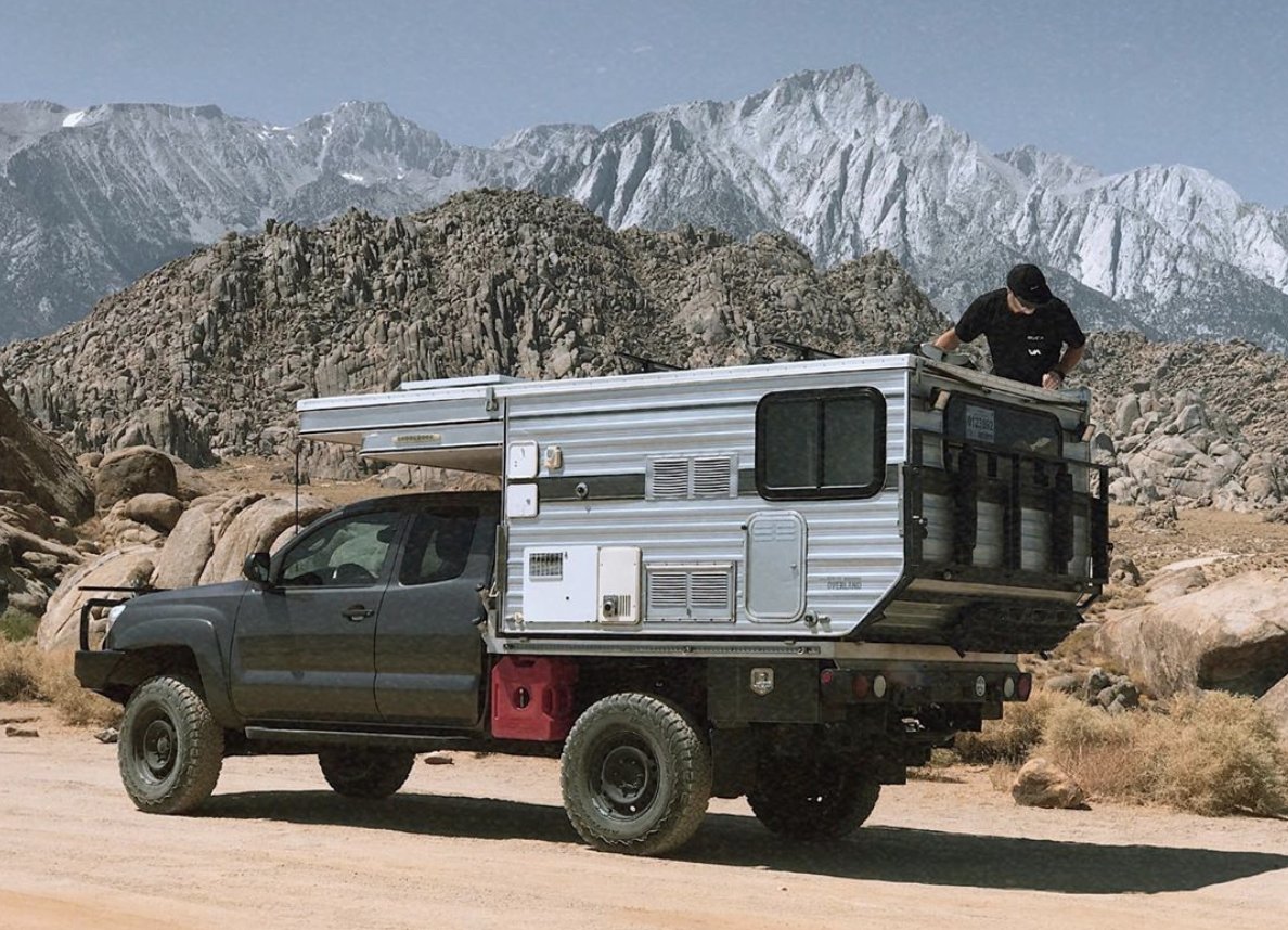

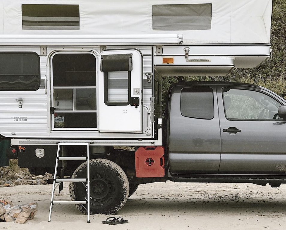

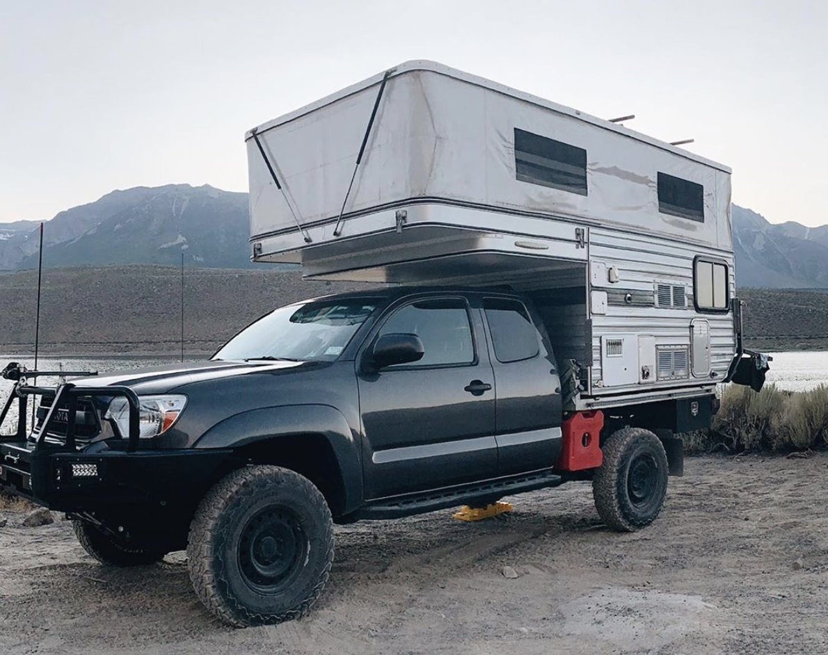

    Screen Shot 2019-09-20 at 1.59.41 PM.jpg Screen Shot 2019-09-20 at 1.59.54 PM.jpg Screen Shot 2019-09-20 at 2.00.18 PM.jpg Screen Shot 2019-09-20 at 2.00.38 PM.jpg Screen Shot 2019-09-20 at 2.00.07 PM.jpg

    That's a awesome setup. Makes my upcoming VB Drifter look like child's play!
