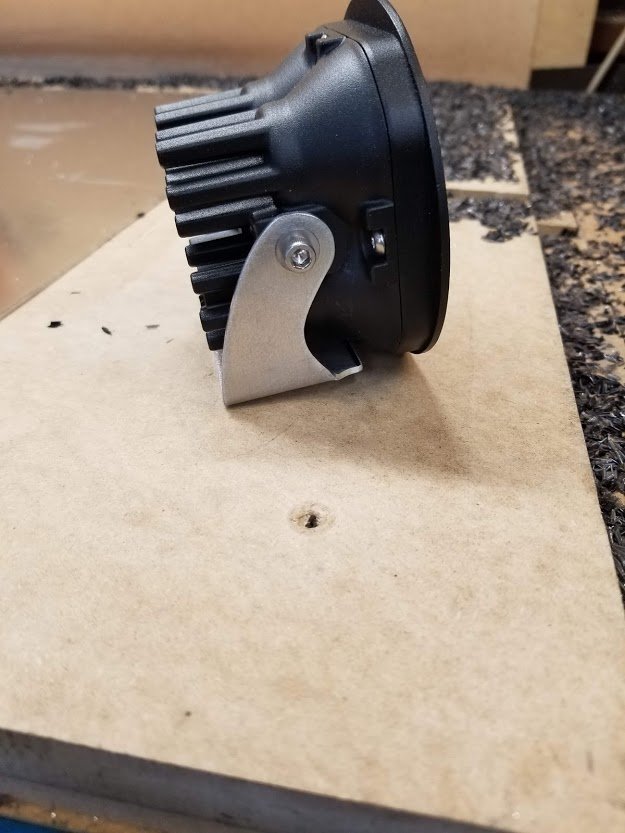

    Hey @paranoid56, I literally just finished the install of my DD. I purchased the DD SS3 fog pods in the pro version. You are correct that the brackets wouldn’t work with the Slee ARB inserts. As user @ardrummer292 pointed out to me a little modification to the bracket proved with the DD kit and .44 cents in a bit bigger washer and she went right in. I ended up tilting the fog light as far forward as I could so it’s angled more towards the road and not at drivers. I feel like I might need to bend the bracket on the Slee insert (where the fog light mounts to) a little up to get more tilt. I’ll be checking this out tonight and evaluate what I need to do. As far as your question, here’s a link that @ardrummer292 sent me regarding his install. I mimicked it as best as possible, results were positive.
    https://www.tacomaworld.com/threads/a-non-enthusiasts-tacoma-build.667560/page-3#post-
    24169871

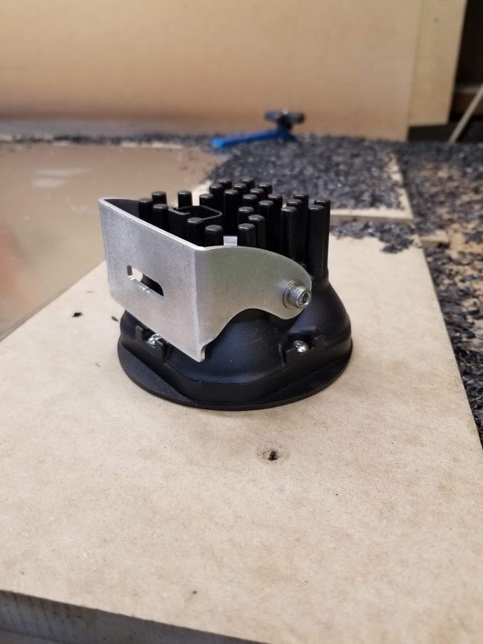

    Nice! I gotta ask, did you parallel your DD bracket with the Slee bracket? I did and the fogs seem like they have a slight angle out to them. It might be how they’re sitting in the Slee housing, but they look like they could be turned in to be more straight on. I’m going to go for a short drive tonight and test them out, and adjust as needed.

    nice, I ended up just making new brackets lol.

    @gardengnome, getting the fogs properly aimed left-to-right is kinda tricky. The pattern is really wide, and there isn’t much of a hot spot to use as an aiming point. I advise covering one up with cardboard so you can aim them one at a time. The front faces of mine definitely aren’t parallel with the bumper, if that’s what you’re asking.

    @paranoid56 those look pretty much identical to the DD brackets after they had been modified. Nice job!

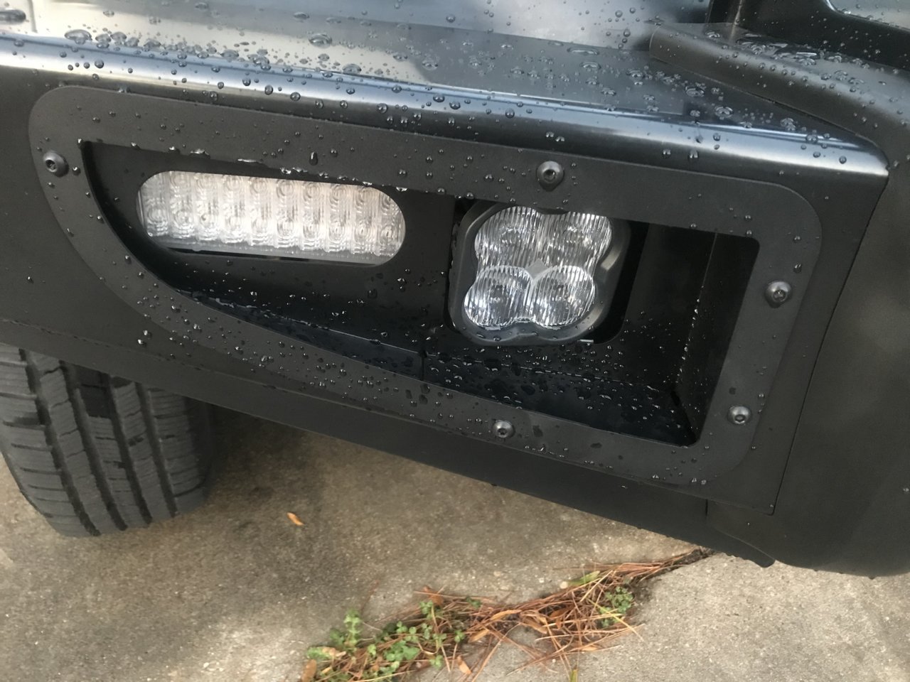

    figured this the right place to ask
    what’s the point of spending money on adapter brackets and changing away from stock ARB lights? I understand their halogen fog can burn out and be hard to replace
    so I have the lights. Need to wire them. I think the little one is parking and signal. And fog is fog. Better than nothing.
    but why upgrade it and to what?
    Only one that sounds obviously good is DD Max yellow fog instead.
    I’m not sure what changing the little light would do. For example slapping a 2” DD pod in there, to try and function as some sort of non-pillar ditch light. Maybe a flood pattern. If it can even aim that way.
    and leave park/signal to the headlights.
    I see folks cut holes all over their bumper to put more lights but it seems kind of sketch to give up that metal and safety crash protection for expensive lighting that might not actually do anything
    one guy did that and reported the only thing he found actually beneficial was fogs and driving beams. Which, driving beams could simply mount elsewhere on the bumper including the tube bars, without doing any cutting.
    TL;DR: what’s the point of messing with it?

    Nailed it on the head. The stock halogen ARB lights put out a driving pattern, not a fog pattern. Totally inappropriate for foggy conditions.
    That’s why people upgrade.
    I would recommend a set of DD Elite fog lights in whatever form factor matches the ARB lights best. That way, you can use the stock foglight surrounds and just upgrade the lights themselves. That said, I can’t say for sure which model of DD Elite that would be, so be sure to do some research.

    even though ARB calls them fogs? Interesting.
    Haven’t wired mine up yet so I haven’t seen the output.
    Got the halogens to have at least something there and keep it as cheap as possible for now
    I’ve heard the ARB LED ones that fit are better and commonly put in, instead of the ARB halogens. Or when they fail.
    But idk if those are actual fogs or not either.
    maybe one option is retain the ARB slim markers, but put DD fogs
    this guy simply put yellow Laminix on his. Looks good but useless if they’re not actually fogs.
