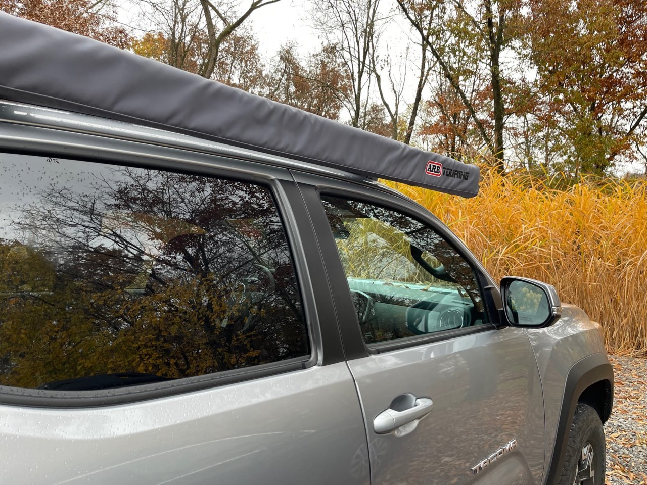

  16. Oct 23, 2022 at 7:01 AM
    #16
    OuchIDied
    OuchIDied [OP] Well-Known Member
    Aug 18, 2019
    #302555
    237
    2021 Silver Sky Tacoma Off-Road
    Here's the rubber trim job. The bracket touches ever so lightly at the front and a little at the rear of the bracket on both the front and rear brackets.
    Lots of glare, but the thing is damn sexy from the sides.
    Lots of ARB branding. Looks good from the front, and would look better with a lightbar.
    A side profile of the rubber trim job. Rubber was reinstalled using marine silicone. The trimmed away sections were masked with tape and sprayed with CRC marine corrosion inhibiter.
