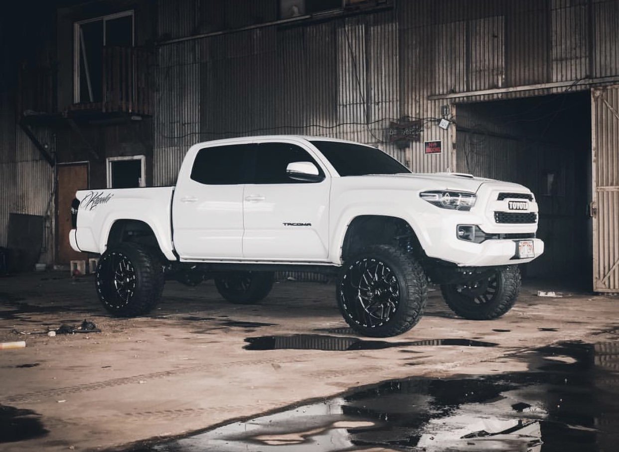

    Not my picture but seen this on another forum. & is the kind of look I wanna go for
    Planning on buying 22x14 w/33’s

    33's will look wayyyy too small. On the BDS Suspension 6 inch lift with fox coil-overs you can max those out to 7 and a half inches. I would run ATLEAST 35's but would FOR SURE run 37's. 33's will look like garbage go with 37's and some 5.29's.
    Check out this guy's truck. https://www.instagram.com/p/BlB1NH8Hvom/

    If I max out the coilovers in the front for that 7.5 would I have to add a bigger block in the rear ?

    I am not exactly sure. He posted on his instagram when maxing out the coil overs so check the comments because I think he explained how he got his level.
