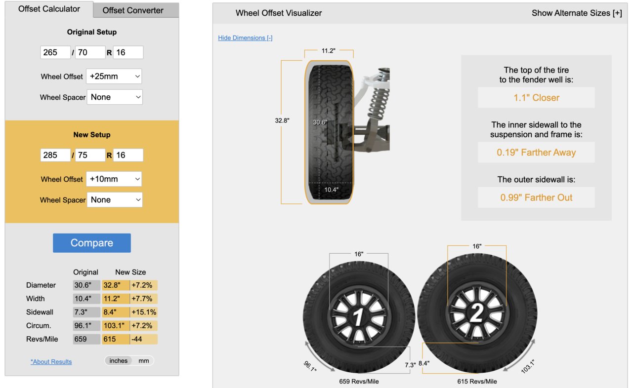

    I'm a new Tacoma owner (2023 TRD Off Road, manual transmission). I would eventually like to upgrade the tire size to 33s. I've been down the rabbit hole of researching lift kits and trimming and realized that maybe this is something I can't really afford and questioned if I really want to do all that.
    I also contemplated going down the pizza cutter tire route. This is actually appealing to me, except for the limited number of tires available (255/85 R16). Most of these are MTs, which look awesome and are great off road, but I need something better in the snow and ice when I'm not off road.
    I stumbled across Tinkerer's Adventure on YouTube, which had a great explanation of how Toyota IFS works and the limitations and trade-offs of a lift kit. In https://www.youtube.com/watch?v=_68Hc8GtLko&t=0s, @ 6:12, it is explained that a lift kit reduces down travel. To me, that seems important and maybe I really don't want a lift.
    In part 2 of the series https://www.youtube.com/watch?v=l1tTelhdEiM&t=0s @ 3:09, wheel offset importance is explained and it is indicated that 33s could potentially fit on the Toyotas he works on, FJ Cruisers.
    https://www.youtube.com/watch?v=LAYGdcKSA3o talks about steps to fitting 33s, and the conclusion is that they can fit on a FJ Cruiser with sufficient positive offset. Note that FJ Cruiser wheels have a +15 mm offset.
    From what I've gathered, stock Tacoma wheels have a +25 mm offset and using 285/75 R16s will rub on the UCA.
    Has tried using wheels with +10 mm to +15 mm offset and a 285/75 R16 tire without a lift?
    Perhaps a used FJ Cruiser wheel, with +15 mm? Or maybe something like one of these:
    https://www.discounttire.com/buy-wheels/tnt-wheels-nitro +12
    https://www.discounttire.com/buy-wheels/dx4-terrain +10
    Attached are the offset calculations from tiresize.com.
    Ricardo13x likes this.

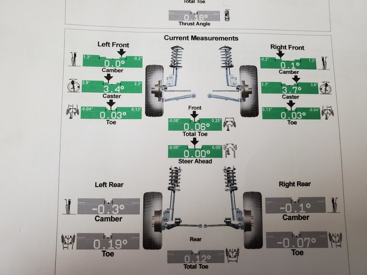

    If you don't mind, I have some questions for you...
    I currently have 285/75/16's Toyo AT3's and a 2.5" Toytec lift using 1.25" wheel spacers on my original Off-Road rims. I wish I had known about these 255/85/16 tires when I put it together and I'm REAL interested in changing as these wear out.
    Here's my questions...
    Since I need a 33" spare anyway, I thought I might buy a 255/85/16 MT and have it mounted on my OEM steel spare rim as a test:
    1. Do you think I could install that spare set-up on a front corner WITHOUT the spacer?
    2. What about WITH the spacer?
    3. Do OEM steelies put the tire in the same place as the aluminum OR rims?

    Thank you for your input. Yes, mine are 32.8" but you know, I just call them 33's. They rub the rear side of the front fender wells when the outside tire edge is turned inboard there (imagine passenger side, hard right hand turn) just ever so slightly when completely stuffed off-road. Not enough to worry about at all (I don't even hear it) but we're talking about a slightly larger diameter tire but, the reduced width may pull the offending tire edge more toward the hub and avoid any rubbing but the diameter is greater.
    You make a great point that, all bets are off with my non-OEM suspension.
    I'm not really into working on cars and I don't anything about alignment geometry. I can tell you that the castor(?) was adjusted on the SPC uca's to move the wheel forward some.
    Good info that the steel is DIFFERENT from the aluminum rims. I guess that's a no go option.
    I think the only way then to test is to put the tire ($350+/-) on a spare OEM aluminum OR rim ($200 +/-) with mount/balance that's a $600 test!:goingcrazy:
    So my current tire width is 11.3" and the 255/85/16 width is 10.2". That brings the tire's outside edge inboard about 0.5" (good) but, gain in radius with larger tire is about .350" (bad). My spacers are required for current tire to clear uca's I think? But if the 1.25" spacers are removed with the 255/85/16 I should expect gobs (technical term) of clearance where it currently touches and still clear the uca's. Does that sound reasonably correct?
    I think that's an expensive test I can't afford. How can I find out for sure if a 255/85/16 will clear mounted on an original OR rim either with or, without my existing 1.25" spacers?
    Could you tell with my alignment specs provided? Should I email Toytec? Post my question in the 3rdGen forum?

    I understand your mention of moving the lower control arm but, I was "told" my castor was adjusted to bring the wheel forward and I know it's different but, doesn't it also count for something? Perhaps not and, I should look into having lower adjusted? I didn't even know there was adjustment down there! I already have the viper cut and CMC so no issues there.
    For now, I was hoping to put a 255/85/16 MT on an aluminum OR rim as a spare (anticipating a full set in the future) but I just don't think it's going to work with the 1.25" spacers which I need for the current tires. Shit!:frusty:
    Well anyway, when the current tires are toast, I'm pretty sure from what I've learned from your input and watching the previous videos that new 255/85/16 on my OEM wheels will fit when I remove the spacers. :thumbsup:

    Normally in the factory configuration "down there", i.e. the LOWER control arm is used to adjust camber and caster since the UPPER control arm is stationary; so "down there" is the factory adjustment location for everything but Toe. With the SPCs in the picture the upper control arm also can be used to do a lot more adjusting in both camber and caster. I understand this can be very confusing and time consuming for the alignment tech if not experienced with the SPCs. My first alignment was a complete failure by the local Schwab Tires (yuk).
    If, in your prior alignment after the lift and SPC installation, they only moved the upper SPCs forward then that would mean they reduced your CASTER. Sure, that will give you a tiny bit more clearance, but the lower control arms are where you can make up the best clearance gain. Also, many believe that with larger tires you should add more caster, not take it away.
    I was told by the successful alignment tech he had used the lower control arms only to gain clearance without the use of the SPCs on other Tacoma(s).
    I really don't understand your problem with your spare tire plan; if you have a use for the spare just remove the spacer, if in the unlikely event you find it necessary. People drive with mismatched spares all the time just take it easy, don't be stupid. Sure, you won't want to be going 70 MPH down the freeway, but it should be sufficient to get you off the trail.

    That was my thinking. My original post had some screenshots of the offset calculator, comparing stock 265s to 285s. A 285 with a wheel with +15 mm is offset is almost the same distance from the suspension as the OE wheel with +25 mm offset running the stock 265 tires.
    The screen grab of the offset you grabbed seems more like -15 mm. That would definitely require some modification!
    I recently found out that the OE Tacoma TRD Pro wheels have a +13 mm offset. Knowing this, I did some more searching and found this thread, and this post in particular sums up my theory / question about using an offset that keeps the wheels tucked in as much as possible: https://www.tacomaworld.com/threads/stock-trd-pro-with-285-75-r16-mts.536754/page-4#post-20833654
    There are claims on this thread that seem to indicate that it works. I'm taking this with a grain of salt though. These are TRD Pros, which have a small lift. This might make it seem like there is more space during normal on-road driving, but in reality there could be rubbing at other places in suspension travel when off-roading.
