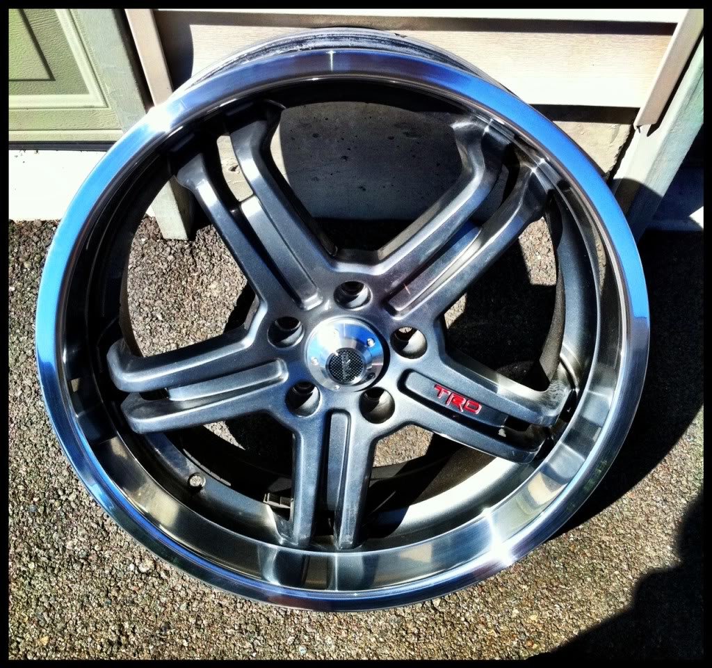

    Has any one tried installing the 19" trd rim that was offered for the 2008-2015 Scion XB. The specs are 5x114 48mm offset and 60mm bore. I have a 2gen tacoma 5 lug ? Any street tacomas running 19"s and what offset would you recomend?

    In terms of mounting the wheel, yes they will fit. For actual use I wouldn't do it. The xB TRD wheel is 8" wide with a +48 offset. For comparison the stock X-runner wheel is also 8" wide but with a +30 offset. Running the TRD wheel will put the wheel tire combo close to 3/4" further tucked. It could possibly be done running a 15mm spacer to get it further out.

    Sorry for the late reply. Yes I currently have them on my tacoma. My truck is not an Xrunner just a base model. The rims and tires sit nice and flush. The rims hub bore sit perfect on the hub and no wheel wobble. The tires are 245/45/19.

    That actually looks really good. I take back my statement on them not fitting well.

    Thank you. Yes they sit nice on a base tacoma but would be way to small on an xrunner. The offset is way to high
