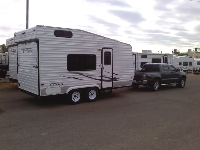

    This was my hybrid, tow really-easy.
    This is my new 16ft Carson Toy Hauler. Nice towing with my taco.

    Isn't the Tongue Weight over the taco limit?
