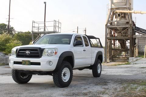

  15. Apr 11, 2017 at 5:10 PM
    Plain Jane Taco
    Plain Jane Taco Well-Known Member
    Apr 19, 2009
    #16179
    40,279
    USA
    The FJ steelies are getting a little harder to come by. If you find a set...snag 'em. And if you're lucky they'll have the cool metal center cap
  16. Apr 11, 2017 at 5:12 PM
    #16
    nastyneight
    nastyneight Well-Known Member
    Jan 15, 2012
    #70735
    6,830
    Nathan
    Wilmington NC
    08 4DR S-Bed
    White Truck
    Im gunning FJ steelies with spacers, was running KO2 34/10./17 now just went to 35/12.5/17. I LOVE MY STEELIES
  17. Apr 11, 2017 at 5:13 PM
    #17
    Clearwater Bill
    Clearwater Bill Never answer an anonymous letter
    Oct 11, 2014
    #140097
    24,314
    Billy
    Largo Florida
    '13 5 lug AC w/convenience package
    A few OE parts from fancy trucks
    Ohhh. That's nice!
    Good thing I don't have a 6 lug. I'd be fitting up trim rings and having those center caps stripped/polished or chromed. :anonymous:
