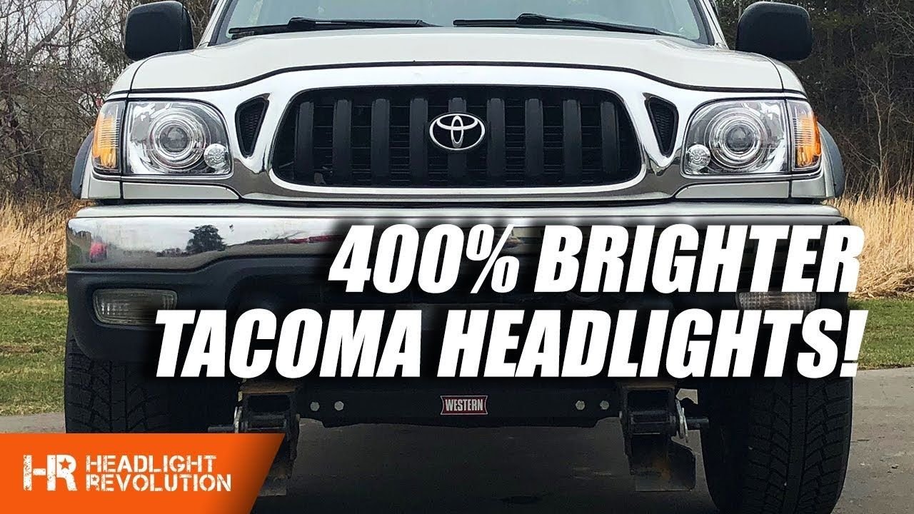

    I’d like to upgrade the headlights as best I can, no HID crap. Where’s the best source to get projector headlights?
    Trying to replicate this kit

    theretrofitsource, wait for black friday and use their coupon codes. sign up for email alerts of deals.

    They don’t have a kit for “1st gen Tacoma’s” but they do have kits for the right bulb type. H4 bulb I believe.
    https://www.theretrofitsource.com/9003-h4-morimoto-elite-HS-H4?quantity=1
    This would actually be the way to go the. Just select the options you want. Be sure to select the H4 harness
    https://www.theretrofitsource.com/bixenon-morimoto-mini-d2s-stage-3-CRK-D2S?quantity=1

    Go to the the universal kits. Choose either the Mini H1 or Mini D2S and then just make sure you select the correct adapter for your bulb type

    you have to do some clearancing (for the D2S) but the projector is threaded and you use a washer and nut to secure it.

    Ya shouldn't be too difficult. Most annoying part will be baking the headlights to get the lens off. But the Mini D2S is a pretty straightforward install
