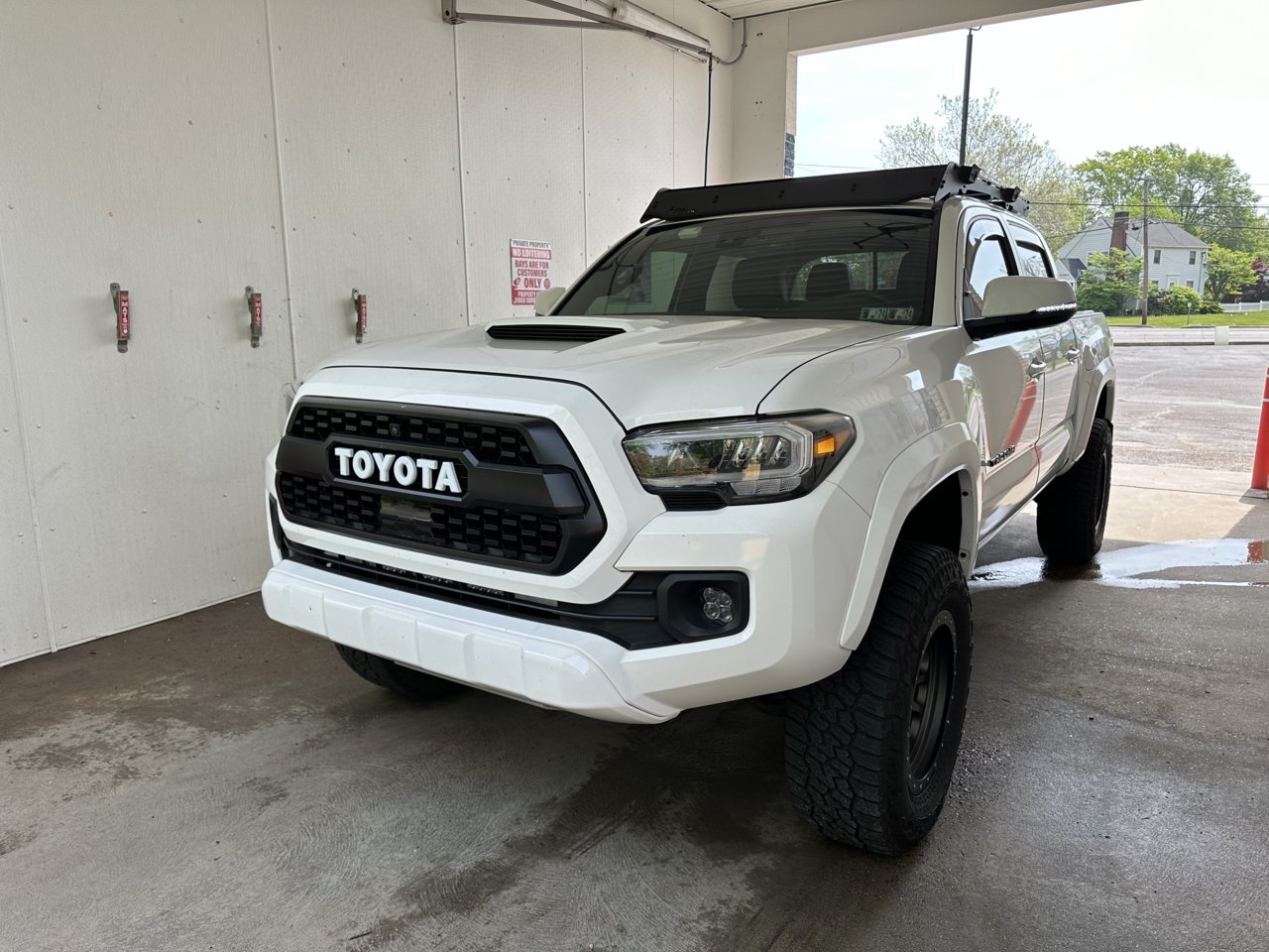

    I have them and you have to grease it yourself.
    I had the dealer do my alignment and the tech was able to get more caster and before and after he worked on it they sent me a video explaining what he did and why. They do alot of lifted tacomas because they have a offroad dept.

    Nice truck! What kinda lift you got? Nice ray 10's, i just got a set of bronze blaze 10's that im putting on when i lift my truck

    Thanks man, i want the blaze 10s but dont want to spend more money. I got 6112/5160 with headstrong aal and their half inch shim. I got the 6112/5160 set to full lift height.
    I was gonna go with jbas uca but i dont want red. Plus i hit them up and asked if i can pick up since im local. They refused, they are literally 10 mins away from me. So i just took my business else where
