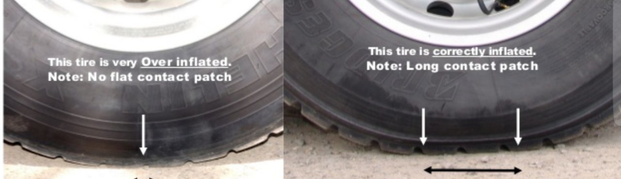

    Take some sidewalk chalk and Mark the treads of your tires, drive around, if it all wears off evenly your tire is inflated properly. If the center is worn but the sides remain covered you have too much, and if the sides are worn and the center remains you have too little.

    On my 2nd gen, I ran mine at 32. I can always get down low and tell what the contact patch should look like. At 35 the entire tire wasn't touching the pavement.
