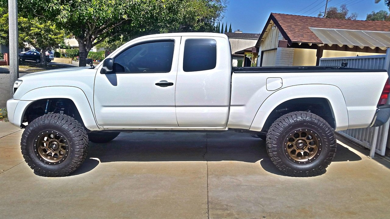

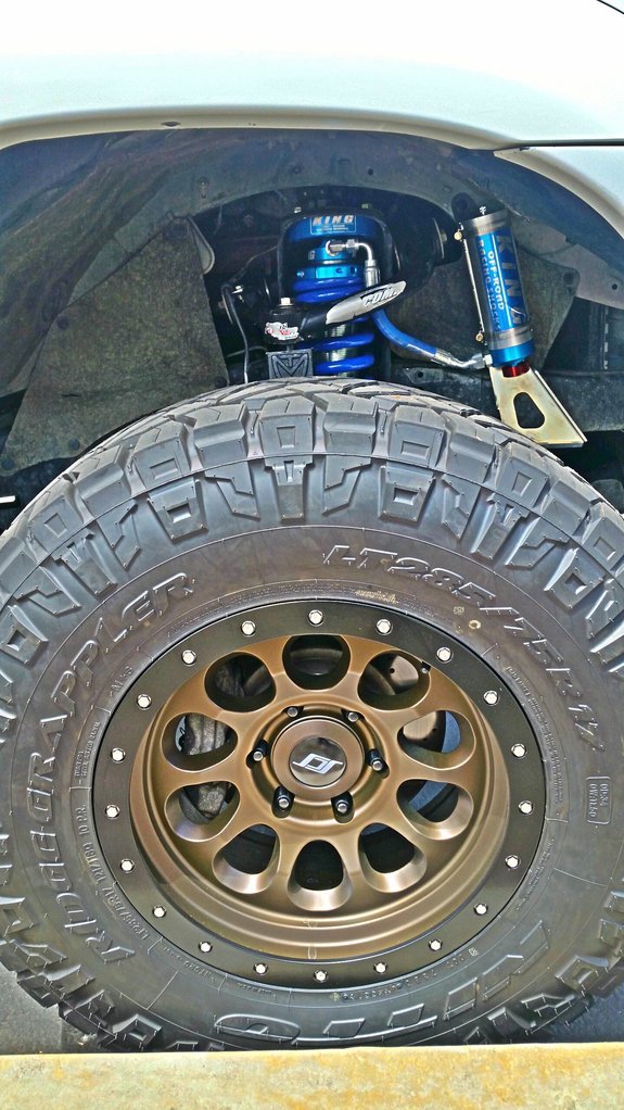

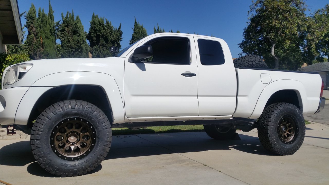

    Somebody called? I trimmed before my alignment, only because I had to commute to work for a week before the alignment, I did NOT want to chew up $1,200 tires lol. Before anyone asks, no, my shop doesn't give a print out of the numbers so I'm not much use :bananadead:
    But I had to do a ton of trimming in the rear before my alignment. Hammered my pinch weld, trimmed the liner, notched the bottom 5" of fender, CMC. I'm lifted about 4" with the spindles & King coils. LMK if you have any questions or want some pics of this tire size.

    Bottom pic was before King coil overs & Maxtrax spindles, just 885 springs for about 3" of lift. Didnt drive it like this, only installed for pics. I dont really have any pics of where I trimmed.... Let me know if you want anything specific.
