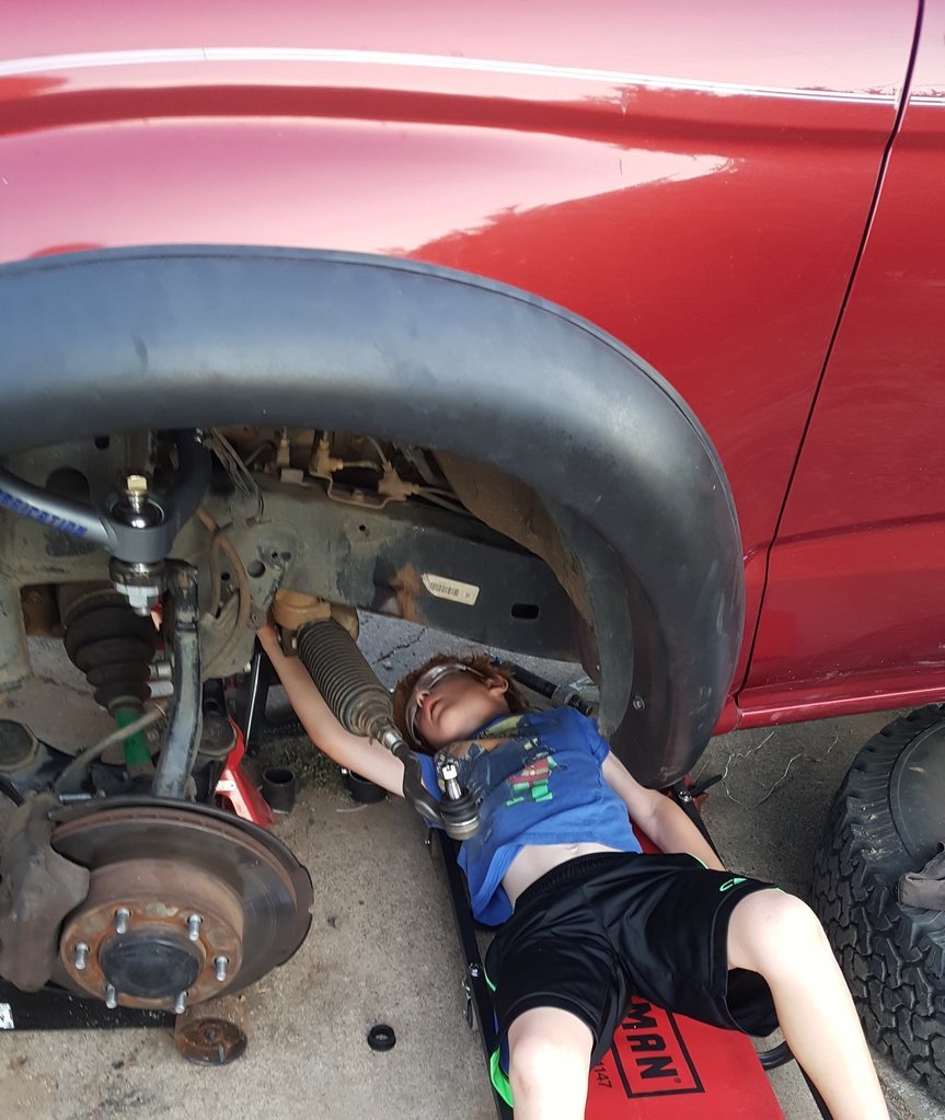

    My son helped me with mine. It's not hard.

    Good on your for having him wear safety glasses.
