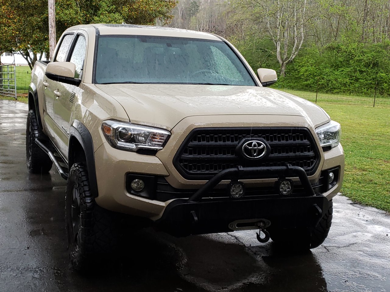

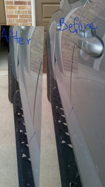

    I put Spidertrax 1-1/4" spacers on my 17 TRDOR DCSB. I did it because I put rock sliders with a kick out on my truck, and the kick out was the widest part of the truck. IMO it looked a little off, and I suspected that if I was sliding it against a tree... as soon as it passed the kicker it would touch the fender. Now the tires are close to even with the kick out and just past the fenders.
    It changes the look of the truck considerably. Guys a work asked if I lifted it, as it changed enough that they noticed something was different. I was going to lift it a bit and get 265-75 16's, but now I'm just going to leave it stock height and still run the 265-75 16's.
    Use Spidertrax. They have a good reputation. I have run their spacers on my Jeep far many years successfully. Follow the instructions and do the check / re-torque. Don't get lazy with that part.

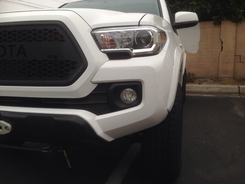

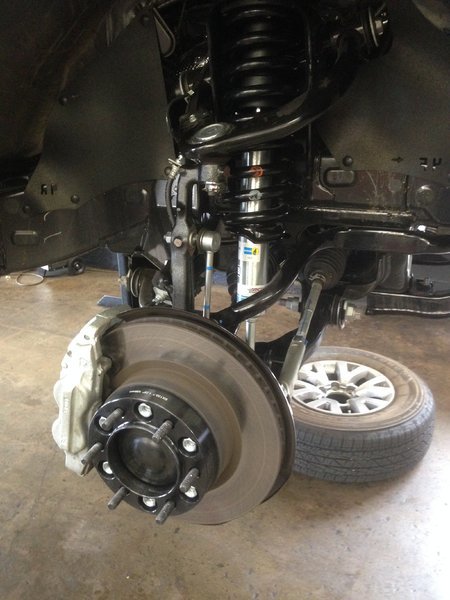

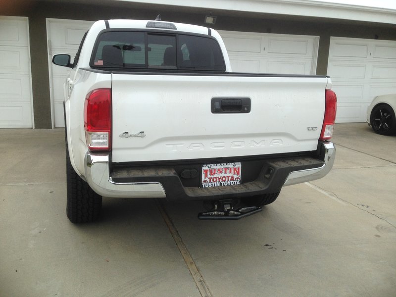

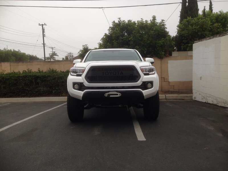

    1.25 front and rear. Amazon black hubcentric and paid 160 shipped. I've used this brand on other vehicles and no complaints, but you get what you pay for! Spyderyrax are the best but I've had great luck with these on other tricks. Torque your nuts every so often and before you wheel, invest in a nice torque wrench! Good luck!!!
