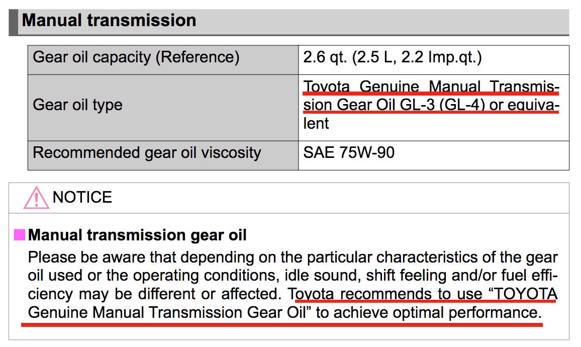

    I was wondering what the price and part number is?
    I Looked in the archives and could not find this info. Thanks alot.

    Amsoil MTG is also a GL-4 oil, so is Redline MT90.
    This was an issue in older cars since GL5 has extra EP additives that can degrade metals used for synchronizers.
    I have never had an issue using the above mentioned.
    Edit: i saw you were looking for a part number.
    08885-81026.
    I tried to buy this once and its not commonly stocked at dealers. They just use whatever gear oil they have available most of the time.

    I actually asked about this oil earlier today in the MT BS thread. That part number came back on a couple of Russian websites and is marked as GL-4. I wonder why Toyota would recommend this oil if it's not even for sale here.

    You can use any GL4 75W90 MTL fluid. I’d suggest a top of the line synthetic for smooth shifting, flows at well below 0F, lasts a long time, etc.
    Redline MTL is cheap as $15, so for $45 do it yourself it’ll last 60K+ miles, or more.

    Called my dealer today about purchasing manual transmission oil. He says they only stock it in large bulk drums. I asked if it was original OEM fluid and he said yeah. As of now I can only take his word for it. I suggest you call your dealer and ask them about purchasing this oil from them.
