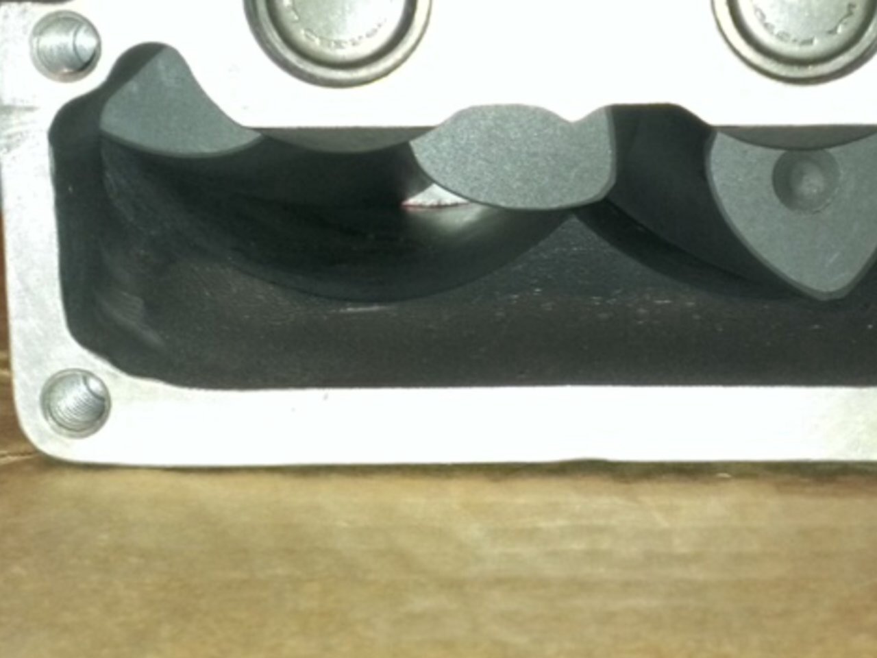

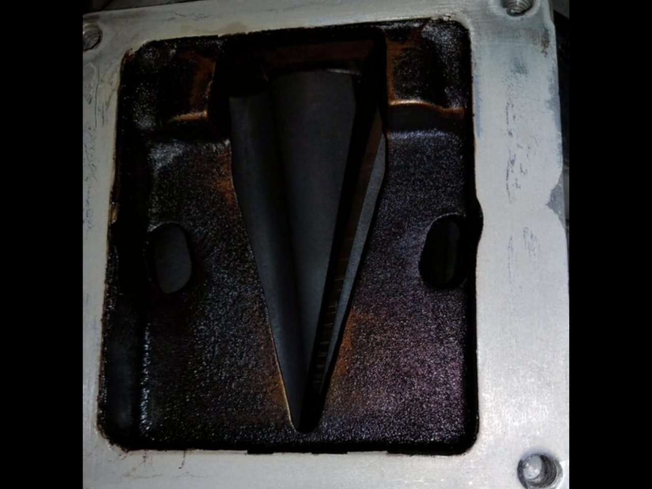

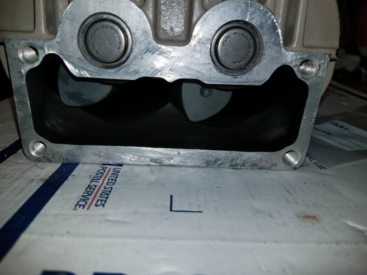

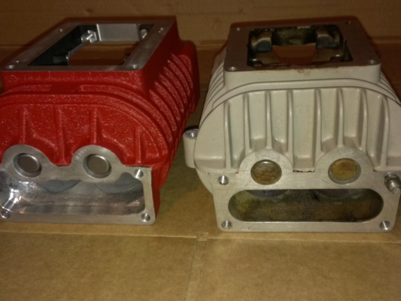

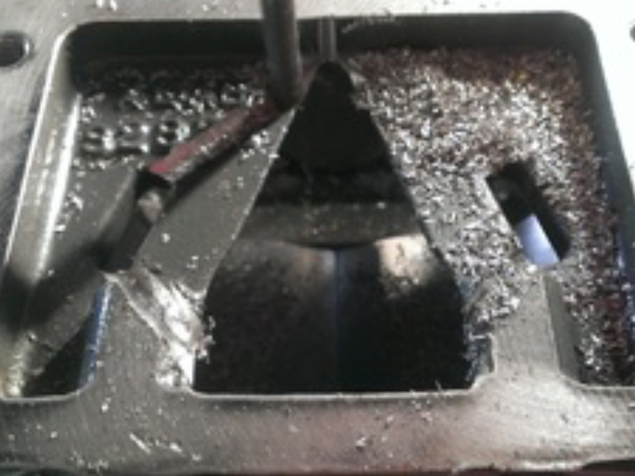

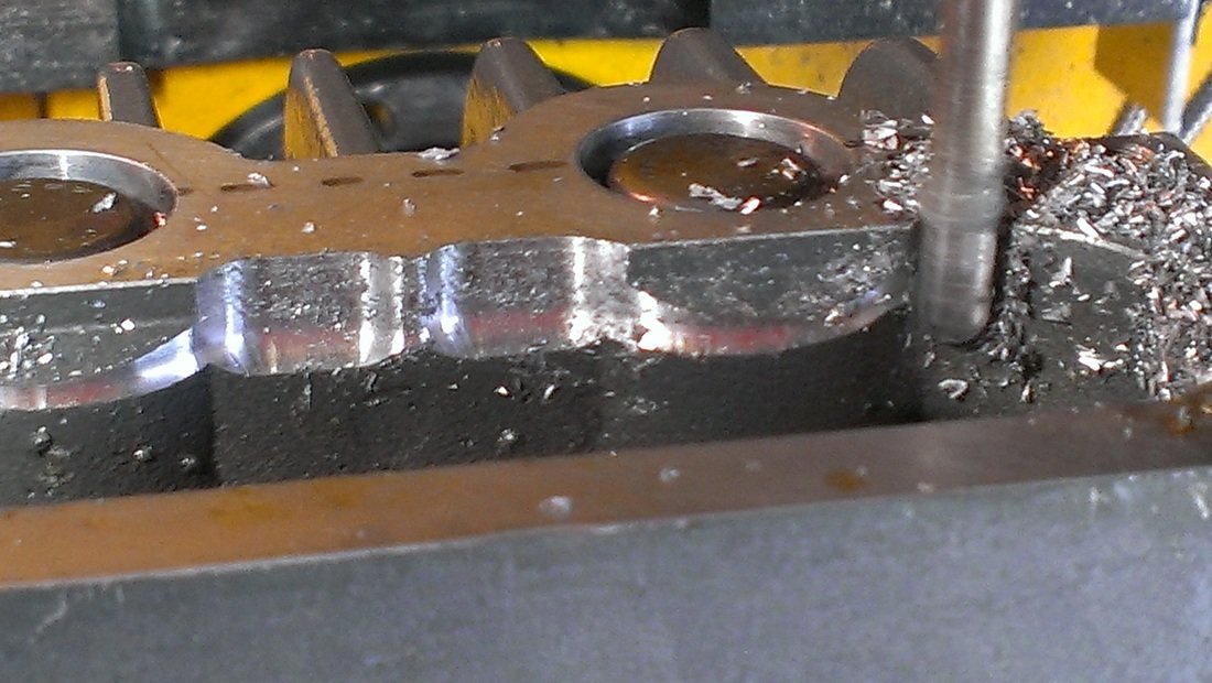

    UPDATE
    Well got my supercharger rebuilt and ported intake and output sections a few months ago 5,000 miles ago.
    The superchargers total power range comes on stronger and smoother now with new added horse power.
    2 weeks ago I Did a full timing service and the battery was disconnected so the ECU was reset.
    Apparently I should have reset the ECU after the porting. With the porting done and the ECU reset more power is there. Didn’t know this.
    So far a happy camper with the new power band.
    Super happy with this upgrade.
    Some before and after photos below.

    Are you seeing more lbs of boost or just the responsiveness?

    Porting the supercharger opens up the airway for more air flow
    less restrictive air so my boost actually stayed the same maybe a hair less
    but more air is being pumped through creating more power.
    So I’m getting more air and more timing, less heat,
    Probably gained easily 15 more horses.
    I have to dyno it again now that the ECU has been reset.

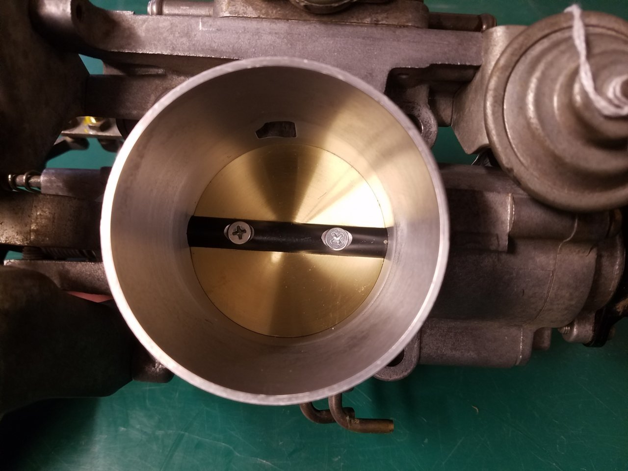

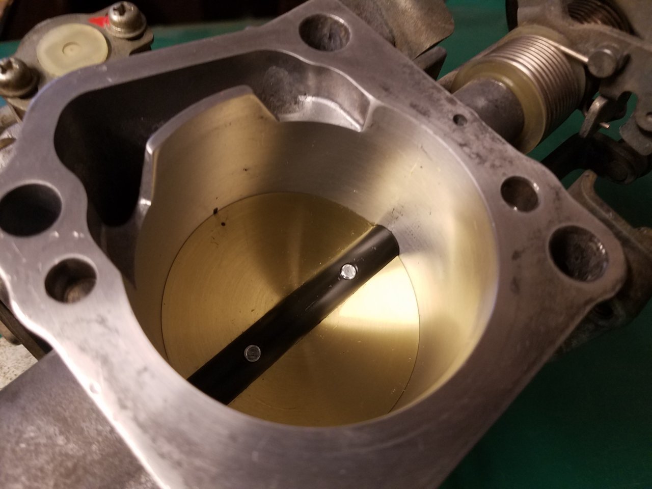

    Also Just got my throttle body back yesterday from maxbore.
    Was bored and new butterfly for a perfect tight fit and ultrasonic cleaning for $125

    Unfortunately I don’t think I can get my TB bored because it’s electronic. However, I called someone about a port on the 2nd gen black SC. It can be done. But I may pick up a first gen if I find a really good deal on one.

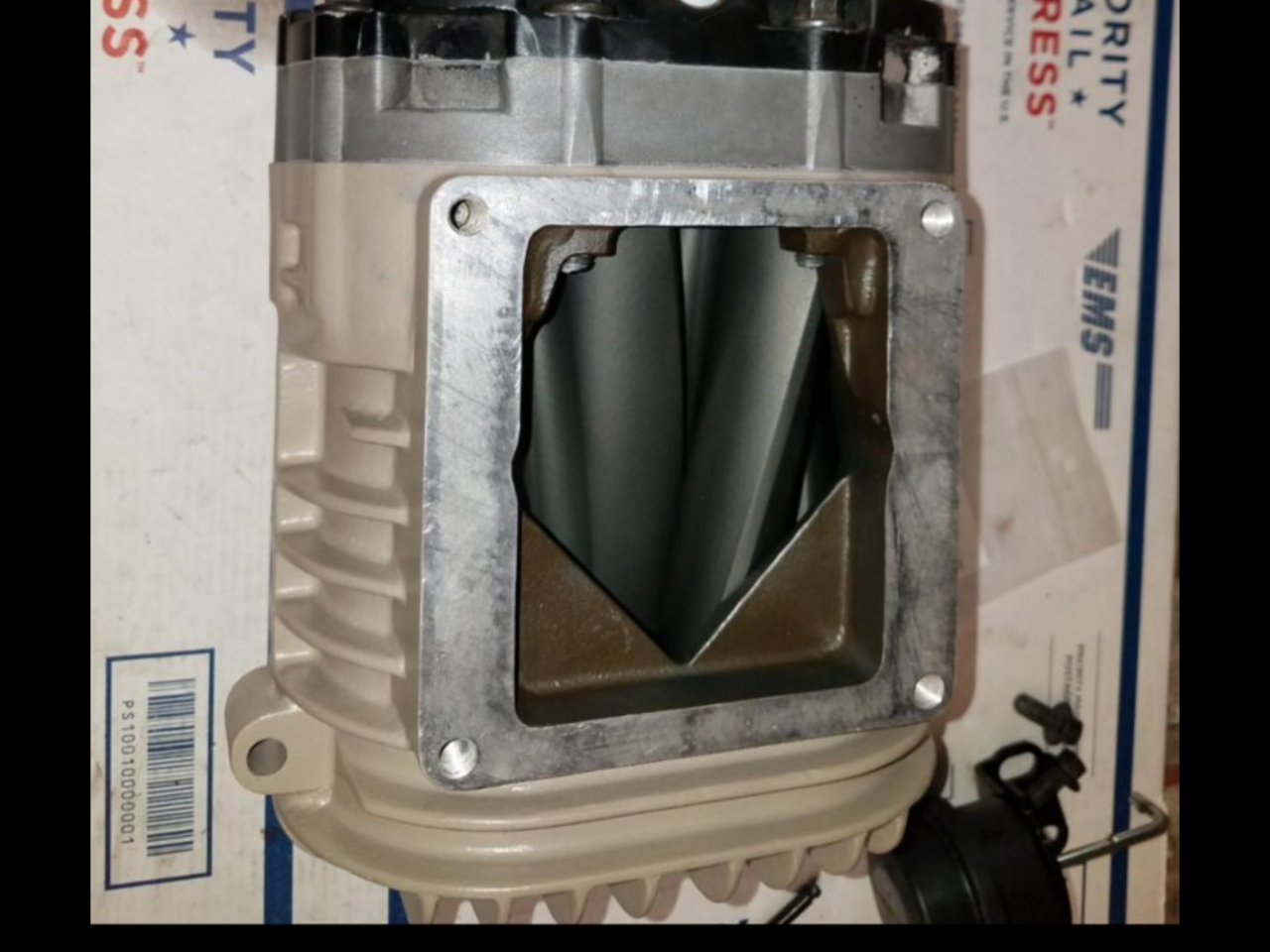

    I should have been a little more clear. I was referring to the 2nd gen 3.4l supercharger. It’s all one piece like the one for the 4.0.
    But it’s can be done. On both the intake and exhaust of the supercharger it seems. stiegemeier Has a video on their Instagram of their “stage 8” port of a Ford Focus supercharger which is all one piece.
