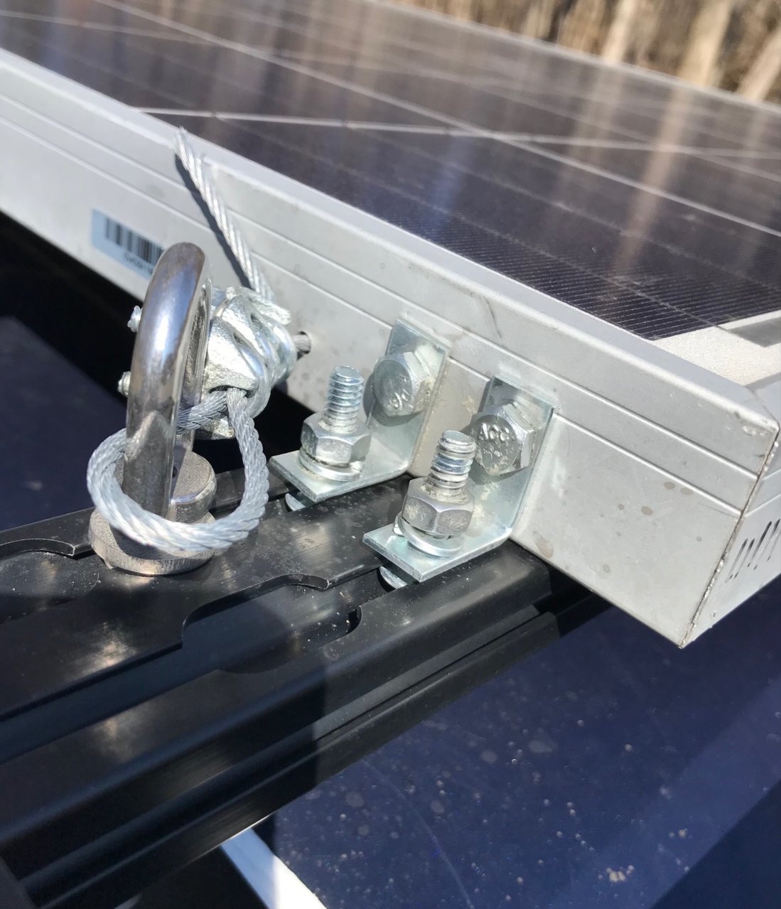

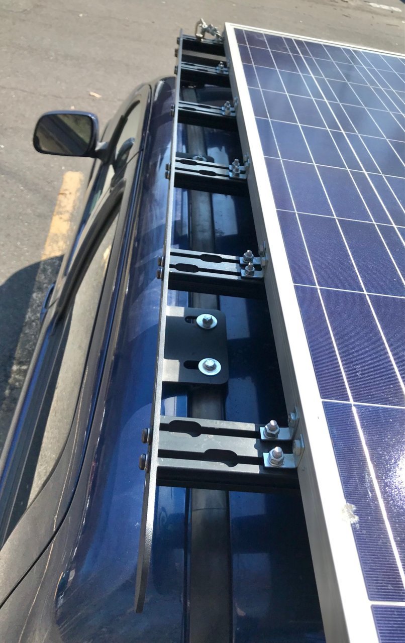

    Anyway, I mounted a Prinsu cab rack to my roof and, to that, mounted a 255 watt solar panel. Did that with 24 steel right angle corner braces and 1/4x20 bolts. If all 24 of those fail, a 1/8" galvanized steel braided rope running through the panel frame will hold it to the rack as well. Did this back in early January. I wanted to double my voltage, so really want to mount another identical solar panel to my Undercover tonneau cover.

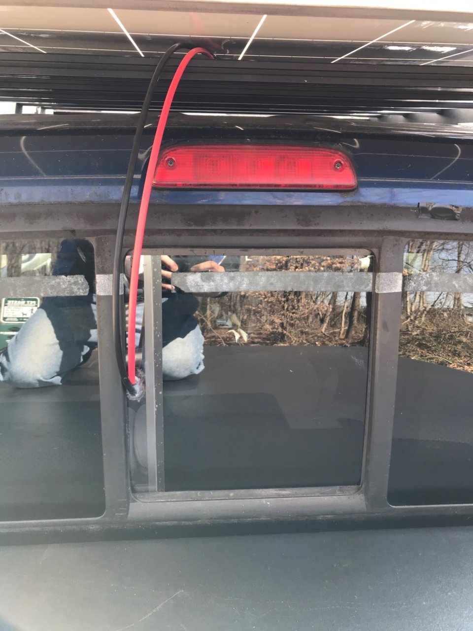

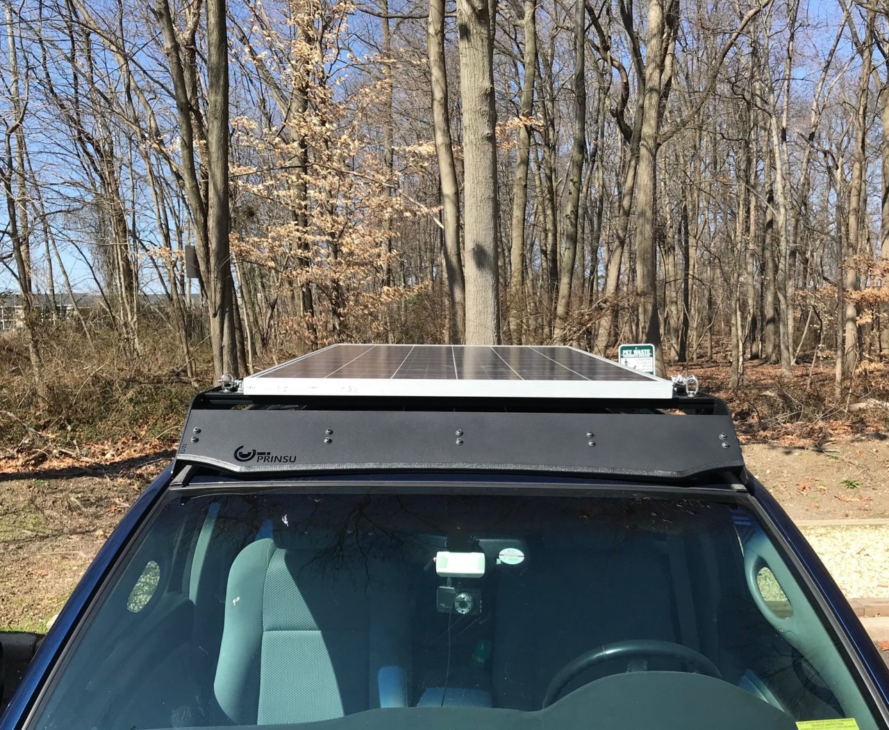

    Pics of the mounting of my 255 watt solar panel to the Prinsu rack. I did not want to drill a hole in my roof to feed the solar panel wires, so I inserted a 2" wide piece of lexan into the rear sliding window frame and drilled holes in that. Sealed with silicone. I then used a strip of clear-ish adhesive vinyl (Oracal 651) to tape the lexan to the window as a seal where they butt up to one another.
    Solar panel is so secure, I can grab it and shake the whole truck.
