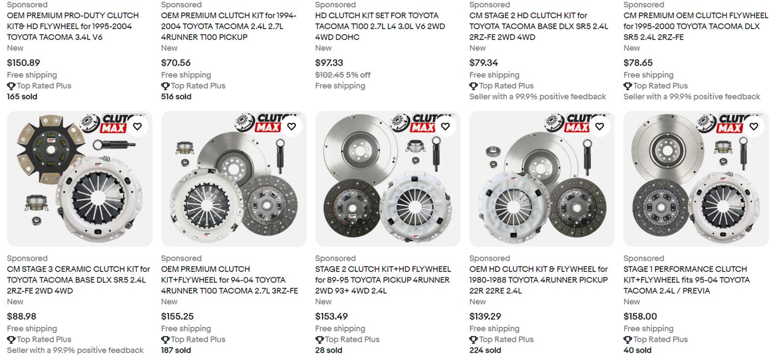

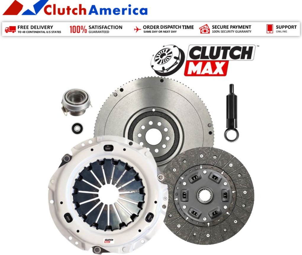

    Ran across a company selling clutches on Amazon (Clutch America). They made clutches that fit my 2000 Tacoma (Clutch Max). Their prices are too good to be true. They are said to be made in the USA, from parts made in various countries (China?). They make so many clutches for so many cars that I could not finish taking a look at all of their 60/page listings of their different clutches after spending about half an hour. I am just wondering whether I am writing off a source that perhaps, and I give that little chance, would work well for my current new clutch installation.
    So, I am looking for anyone who has purchased and installed one of these clutches on their Tacoma:

    looks to me like it's a discount product with a discount result.
    this subaru forester/impreza clutch speaks to a product that is barely adequate to basic around-town driving.
    https://www.amazon.com/ClutchMaxPRO...s/B08FF4M57P?ie=UTF8&reviewerType=all_reviews
    or the civic clutch seems to have repeated issues of not disengaging, and issues with the return window after figuring that out
    https://www.amazon.com/ClutchMaxPRO...s/B08FNVY6JY?ie=UTF8&reviewerType=all_reviews
    reading through many of the other variations with at least 15 reviews, it seems there's significant and recurring issues where it's 'supposed to fit', and doesn't, also a few cases for every variation where it goes out 1-2 months after install, far outside the warranty/return window.
    i wouldn't trust or recommend this clutch in my vehicles.

    Clutch job is not something I'd want to have to redo, personally I'd stick with something tried and true like an Aisin clutch, I've heard a lot of good things regarding Exedy brand too.
    Particularly with cheap bearings involved, you don't want an input shaft or throwout bearing failure not long after you put it all back together

    Clutchmax is a scam . They sell very poor quality clutches on eBay under clutchamerica and on Amazon under global parts connect. Same person owns all three companies . Do not buy from them trust me. They jack up their reviews to make it seem like the product is good.
