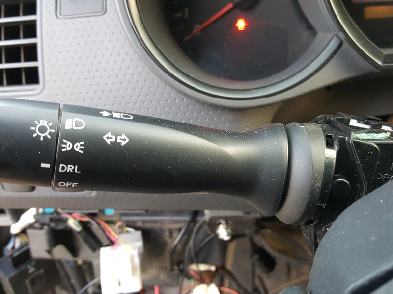

    I replaced mine with the 13 switch.20161204_161057.jpg you have to remove the steering wheel to replace

    the switch is about $75 from the dealer. you might find it a partsgeek.com. the steering wheel removal is really simple. there is a thread on here. 05-12 switches should be the same 13-15 had the drl option and I made a right up about that in another thread. all will work with any year plugs are the same through out

    @desertrunner24 nailed it, $40 for a switch from a 2010 Corolla vs. $65 for 2010 Tacoma vs. $80 dealer new. Apparently that switch fits a ton of Toyotas and a few Scions. If I had more time to shop it probably could have been had for cheaper but it's kind of a shitty thing to not have while driving around. I used to do the same thing with my old car since Lancer Evo interior = Lancer interior = Mirage interior, and same for most parts for all three - major difference being motor/turbo/trans and about a 1,000 weld points. You can guess which ones were cheaper and direct fits!

    But yes, installed Saturday in about 30 minutes.
