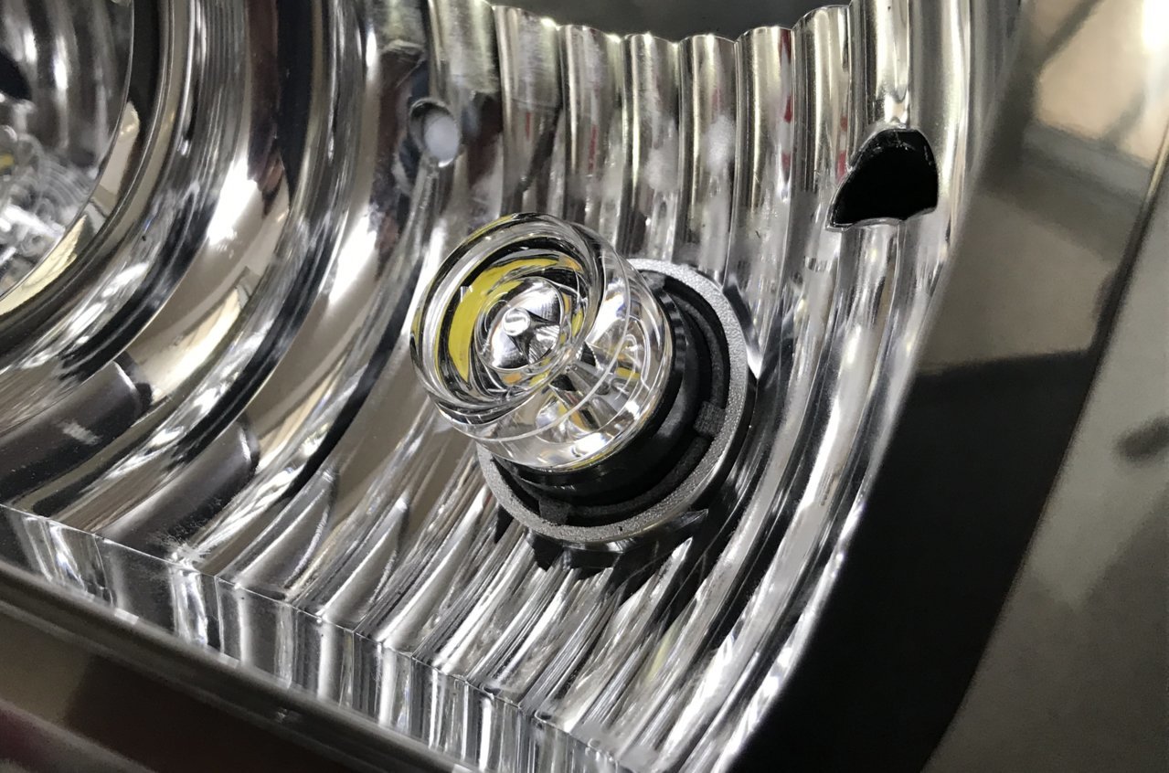

    I’m always curious as how moisture gets in on factory brand new lights. The tail lights are actually plastic fused at the seam (between the outter lens and the backside bucket) if I were to bet, that’s not the culprit. Could be a bulb adapter not seating correctly, or even the breather vent cap not on all the way.
    The tails have 2 vents, and the headlights have 3 IIRC.
    They look like this (black cap upper left of the bulb hole) then to the right is a grey membrane seal that allows only air to pass
    Here is the other side you can clearly see the hole in the chrome reflector bucket(upper right)
