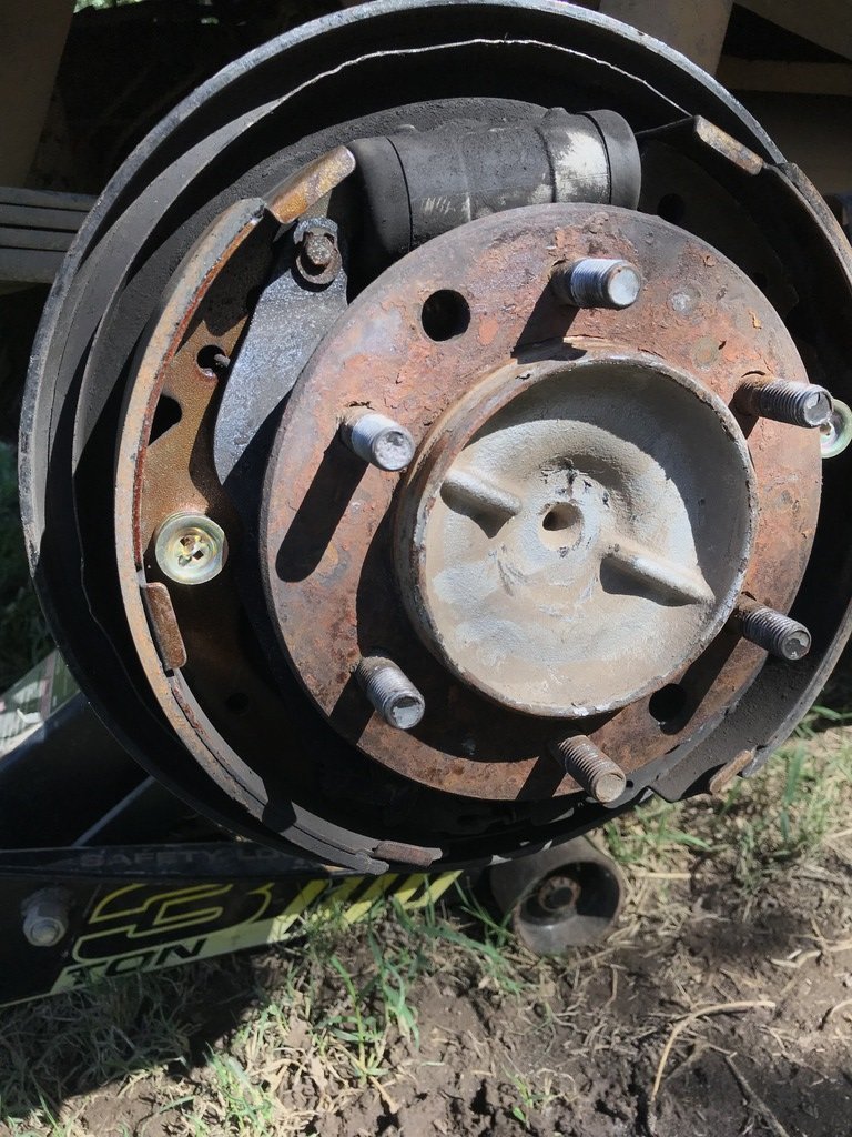

    Twice now I've had to thread bolts into the drums to get them off.
    After the second time, I made sure to have the rear brakes adjusted correctly.
    The theory is that the rear may have been out of adjustment, causing excessive play.
    I thought that the play was more then what the retaining clips/springs could handle...causing them to come un-done.
    Now it looks like it's happened again :(
    Drums seemed be within limits.
    Will verify once I get it off...may try replacing or have them turned on a latte (if within service limits).
    Before I force the drums off, anyone else encounter this issue?
    Uploaded a sample pic that I found online.

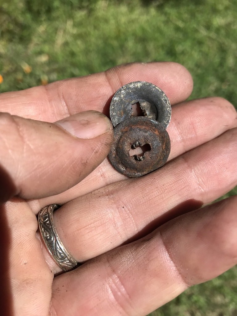

    Both brake-shoe retaining clips were quite worn, allowing pins to slip through.
    Didn't notice this, the last time I dealt with this.
    Ordered replacement drums, as they are reaching end of service.

    It looks by your backing plate that someone may have tried to pry the drum off with a bar or something.
