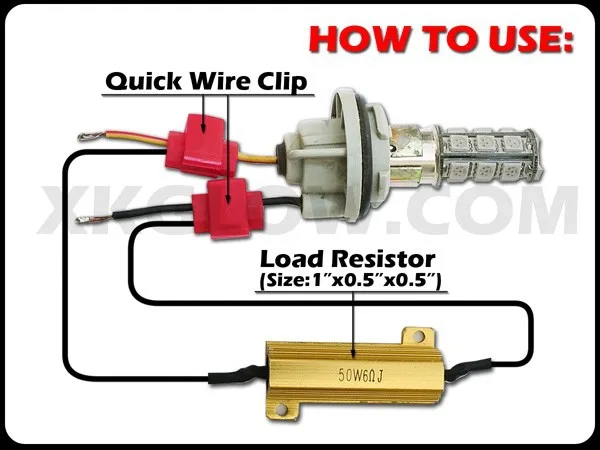

    Does it matter which wires you splice the transistor in at? what type of resistor do I need? I bought 50W transistors, wired and still causing hyper-flashing. anyone else think of the reason for this?

    The resistor connects in parallel to the bulb, but unlike wiring batteries or speakers in parallel a resistor does not have polarity. So one side of the resistor is on +12v the other is ground on wires going to LED. This is why heavy duty wattage resistors are required.

    gorram, thanks for the picture of how it is wired. only thing I notice is that there are 3 wires for the light housing. not just 2. I assume as long as it run in parallel with the light it shouldn't matter right?

    In that case one leg of resistor to ground wire that feeds bulb. The other to the +12v wire that is the flashing turnsignal part of light. The 3rd wire that you would not splice into would be the +12v constant running part of the light.
