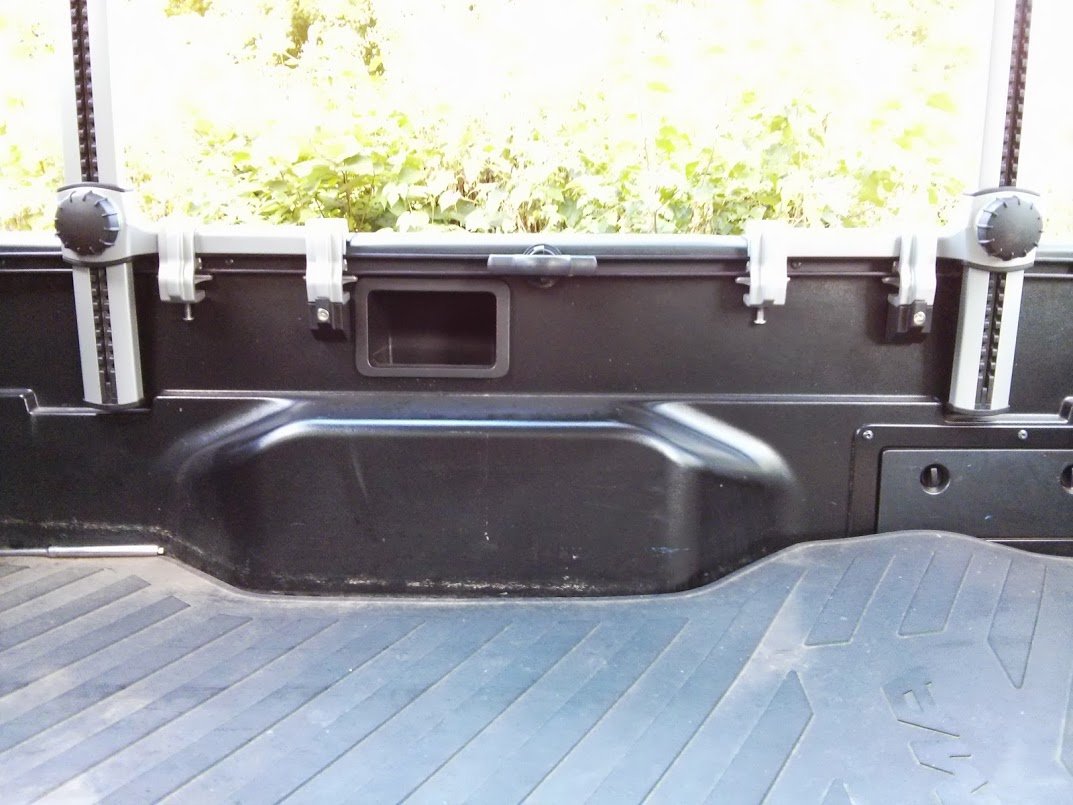

    My RTT sits a little higher than I'd like but the uprights are as low as they will go. This Xsporter is a little different than the last generation as it has 30 or so plastic height notches inside the aluminum upright.
    Wondering if anyone has cut a few inches off the bottom. If so can you link pics and are you still able to install the key locks?

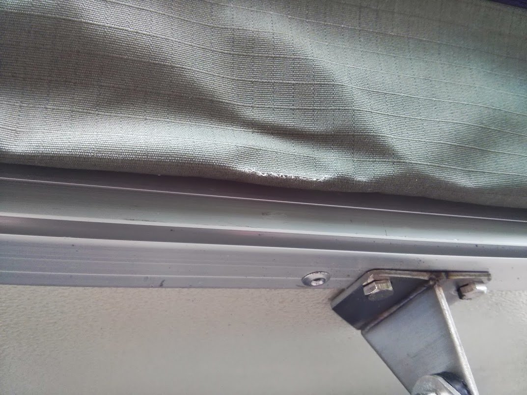

    Other reason is there seems to be so much buffeting by the wind that it is causing some small fraying to the tent edges under the vinyl travel cover... Not sure this tent will last more than a year or two at this rate.

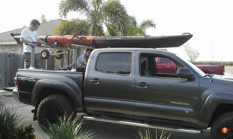

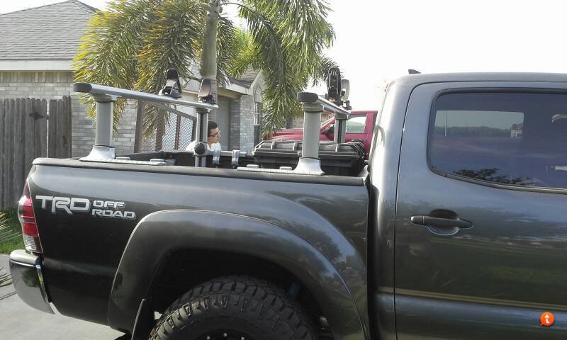

    Just cutted mine 6.5 inch to be safe .. still need that extta height for kayaks and other toys .
