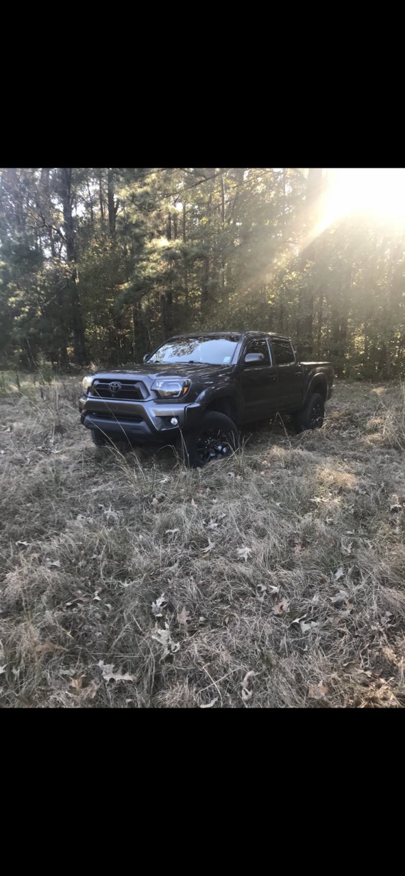

    There's a decent amount of blue and gold metallic in MGM which makes a match difficult (ignore the dusty pinstripes).
    Tacoholix[OP] likes this.
