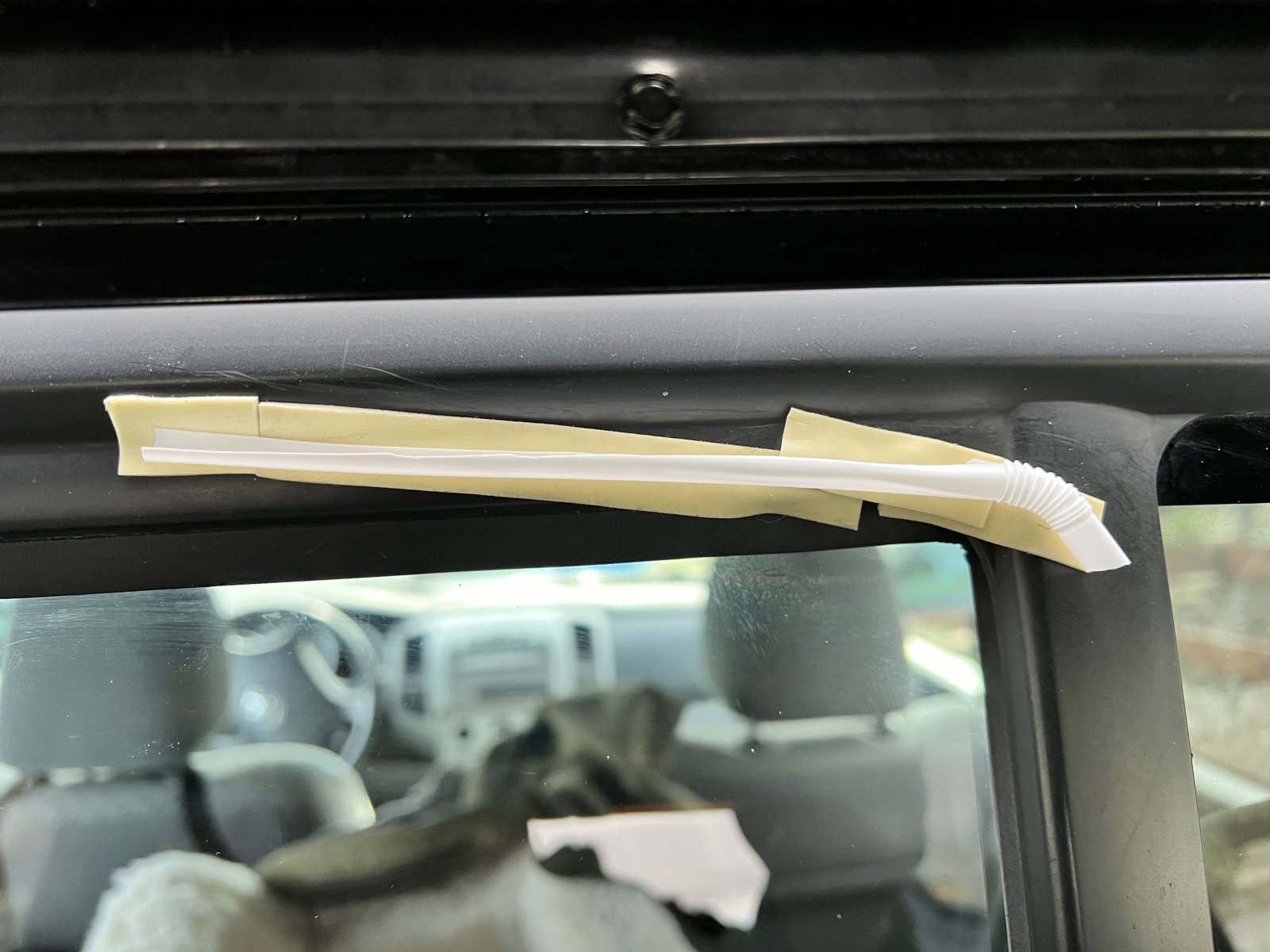

    you guys are going to die. this os just a prototype of what I'm envisioning. it won't rub the glass of the shell at all - its just a cut straw and if i mirror it, i think the water will drip down on the frame, not the glass

    thanks @OffroadToy i got some similar "rv adhesive raingutter" and i was only able to do the center before i ran out of time. i cut the 2 pieces to put a peak in the center and slight angles down on the sides.

    i added side pieces... we're expecting rain later today, so we'll see how it works!

    So go figure: putting the rain gutter on the cab window only prevents rainwater on the cab window

    i put a strip on each "side" window
    of the cab slider and 1 piece like an arch on the frame above the slider.
    these rain gutter strips don't impede the amount of vision through the rear-view
    mirror at all. the limiting border of vision is actually the opening of the shell rear door.

    here is my rear view... it's sooooo clear!! almost like there are no windows there at all. hard to see it but the cab slider and shell slider have minimal water, its just beaded up on the shell rear window.
    i am so stoked about this!

    very simple I like it. Hard to tell from the pics, do the two seals on either window press together and touch?

    no, there is about a 1/4" gap front to
    back between the seals on the windows.
    the center window, on the shell side, i had the to put the raingutter on the frame, above the window (and highter than the seal on the cab) because if i put it
    on the glass, it wouldn't slide open.

    here's a peek from the side
