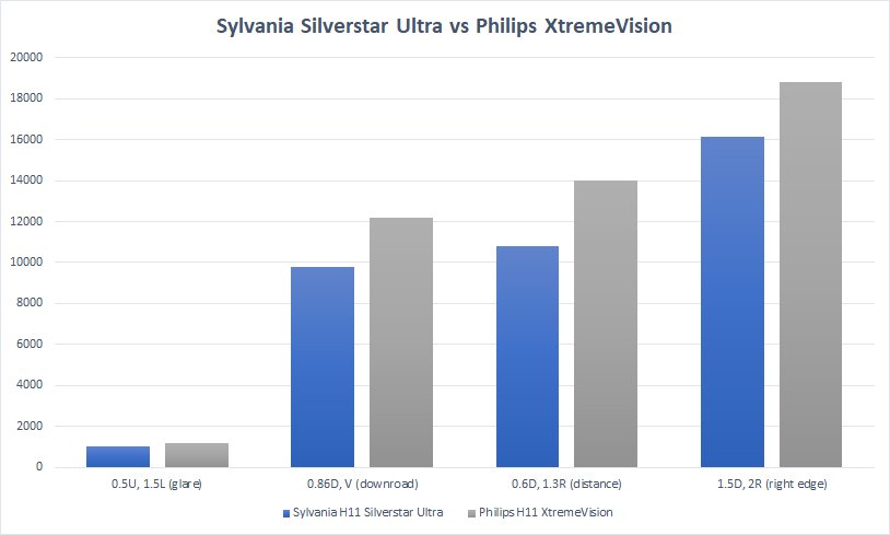

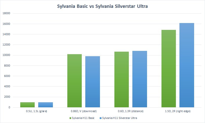

    Coatings to create whiter light reduce output. Regardless of what the marketing says, it won't look like LED. Halogens cannot operate at that high of a color temp and put out any reasonable amount of light, as blue coatings remove light to make the light appear whiter. The whiter you go, the more yellow light must be removed from the spectrum which reduces the light output. If you wanted 'whiter lights' without sacrificing performance with a fully coated bulb, I'd suggest the Osram NightBreaker Laser +150. You can see in the output charts they are a good improvement over stock while also being whiter. But compared to other performance bulb options, they are not the best as the blue filters to achieve that whiter color are reducing the output. The best H11 for output intensity is the GE Xenon +120, which uses almost no blue coating and instead relies on Xenon gas fill instead of halogen gas to achieve a whiter color. Using Xenon gas is more efficient at increasing the color temp as no light is removed, unlike blue coatings, to achieve the whiter color temp. However, it isn't as white as the blue coated options and Xenon gas is far more expensive making the bulbs more expensive than other options. While not as performant as the Xenons, the GE Megalight +130 are a very good balance of color vs output and cost. Bulb life for these performance options is short though, 150-200 hours, meaning based on my use I'd expect 9mos-1yr. YMMV depending on how often you run your headlights.
    As to the Silverstars, they are known for producing whiter light with very short bulb life an minimal performance gain, if any. Some Silverstar models put out less light than stock bulbs, as they are prioritizing whiter color over product performance.

    Halogen performance is a spectrum, the higher the performance the shorter the life. That doesn't mean you need to go to the extreme performance end of the spectrum and go for very short life to achieve performance gains. The Philips Xtreme +100s are a good middle ground option that will offer improved output over stock while still maintaining decent bulb life (400hrs) that should last 2 years based on my use. They won't be as high intensity as the highest performance bulbs, but they will also last significantly longer while being a decent bump up over stock. You can choose how to prioritize your performance vs bulb life and buy a bulb to match your needs. Personally for me, I don't mind changing bulbs annually, I see it as a small price to pay for the best output possible but not everyone shares that view and for those there are other more modest performance bulbs available to meet those needs.

    Everyone's eyes are different... I've tried most of the lights crash has recommended, but I always have come back to these Philips bulbs. They are just the right temp for my eyes, plenty bright (I'm currently running them in fogs and lows).
    For me I absolutely hated those Sylvania Ultras - filters out too much light in the spectrum and it was very noticeable and even dangerous to my eyes in rain.

    This says everything you need to know:
