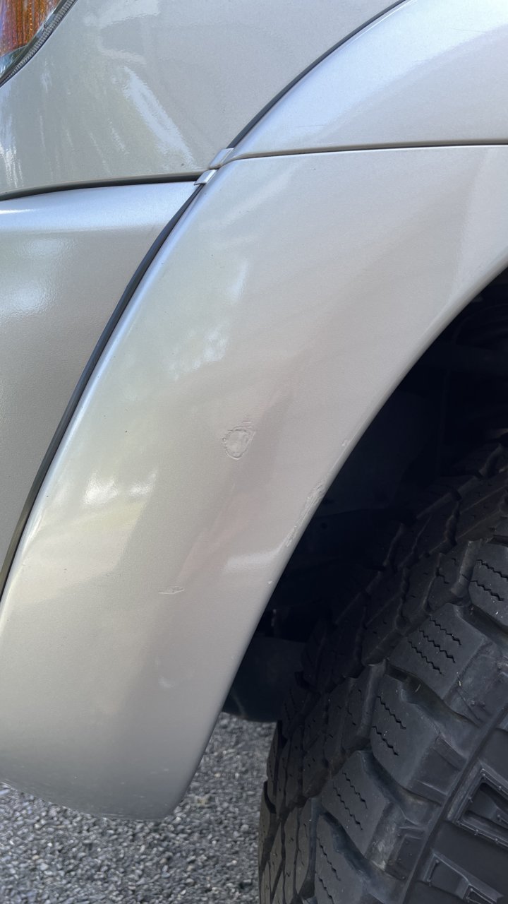

    I replaced my front bumper end last year and ordered paint from
    Automotivetouchup.cm
    Good quality and it came out great. Took my time used adhesion promoter
    After and before 62152415-5080-4CAC-958D-CDD0B50A4CD1.jpg8F2F4320-B8DF-44A3-9D8D-3F355B3EA9EF.jpg

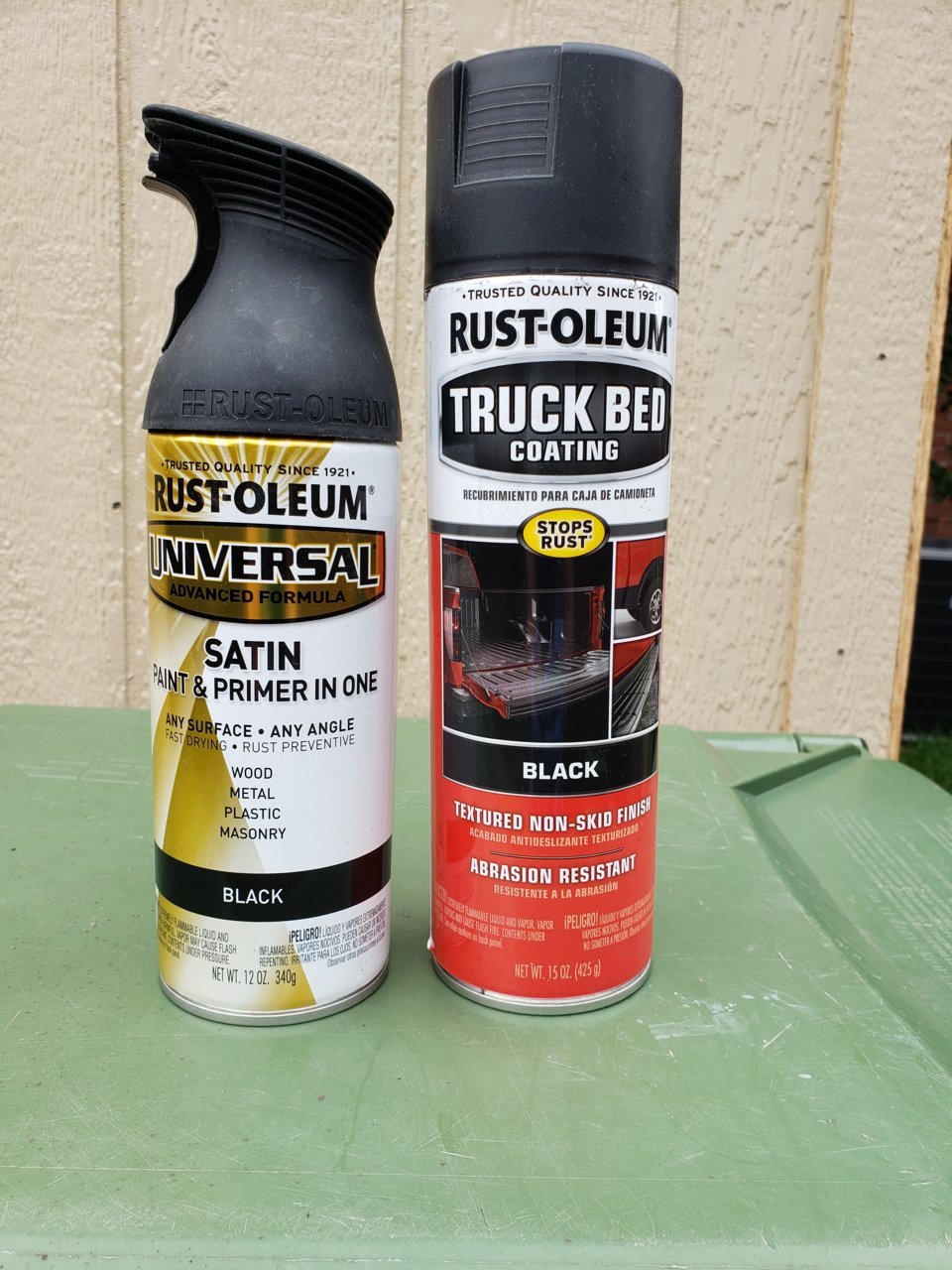

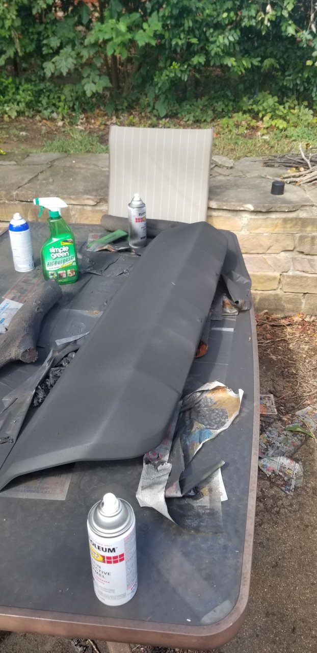

    I've always go with rattlecan rustoleum bedliner that I usually find at Home depot. Holds up well and easy to touch up. I have even finish the last coat with krylon black satin to make future touch up easier and cheaper since I like the satin finish.

    I've done this as well. works great, just be advised that when washing textured coatings, use a spft brush, as a spong or cloth will catch on the rough coat.

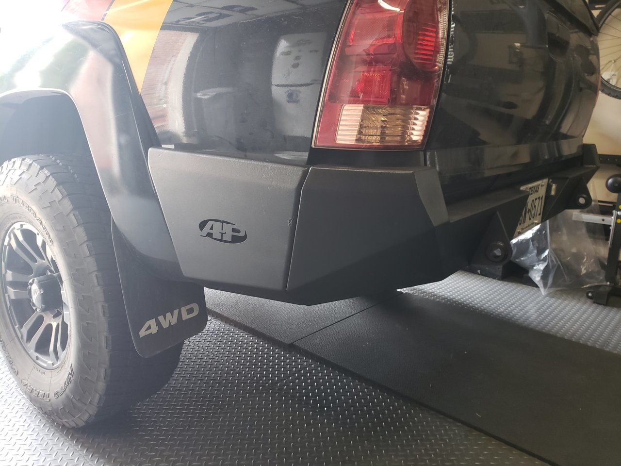

    Its not as cheap as rustoleum, but Steel-It is an amazing product. I repainted my Pelfreybilt HC rear bumper when I had the sides shortened (didn't want to pay to strip and re-powdercoat it) and it turned out great. Ill soon be doing my AllPro aluminum front bumper which has fading powder coat. They only have black and grey from what I remember, and its about $25 per can. I used 1 can to do my rear bumper and a little from a second can.
    TLDR, Steel-it is amazing and get it.
