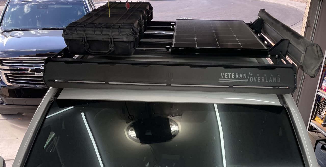

    This is how I mounted mine while in transit: all-thread on the 80/20, knobs to secure. I have a 30 foot cable that I can connect to the panel while on the roof, or take the panel off in about 30 seconds and follow the sun. I have an Anderson connector on the front bumper to plug the cable into my Off Grid Engineering Redarc system...

    This is what I was thinking about doing, plus when I'm home I can store the panel off the truck. Can you explain how the all-thread attached to the 80/20? Nearly identical setup to mine but reversed, hard case on drivers side and panel will be on passenger's side, I'm hoping the leads on the panel are long enough to connect to the cutting edge mc4 connector port I plan to install on my cap if I can convince myself to drill a hole... I was going to just run a self contained jackery type product so that it is portable as well. Then I can just take the whole thing wherever the sun is and not worry about carrying an extension.

    I use the @upTOPoverland tracnuts on my Bravo rack for the all-thread, but t-nuts would work as well...the tracnuts just drop in to the slots. The knobs are M6 star knobs from Amazon.
