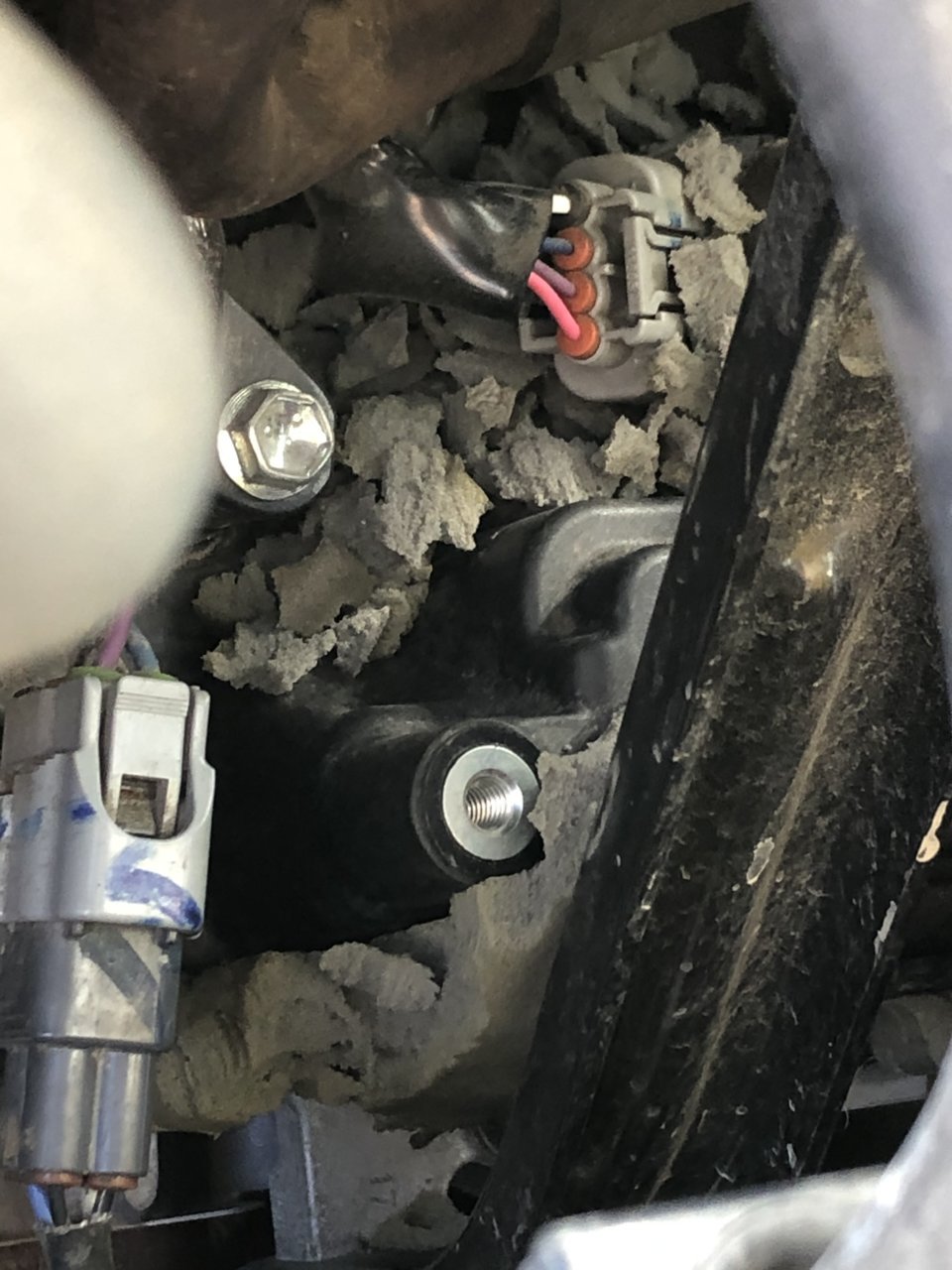

    Are they under the hood or inside the cab?
  5. Feb 9, 2021 at 1:36 PM
    #25
    NWTacoTime
    NWTacoTime [OP] Well-Known Member
    May 14, 2019
    #293281
    1,320
    Nate
    WA - Seattle/Kent
    Cement SB 2019 TRD offroad -
    Car Seats
    In the hood

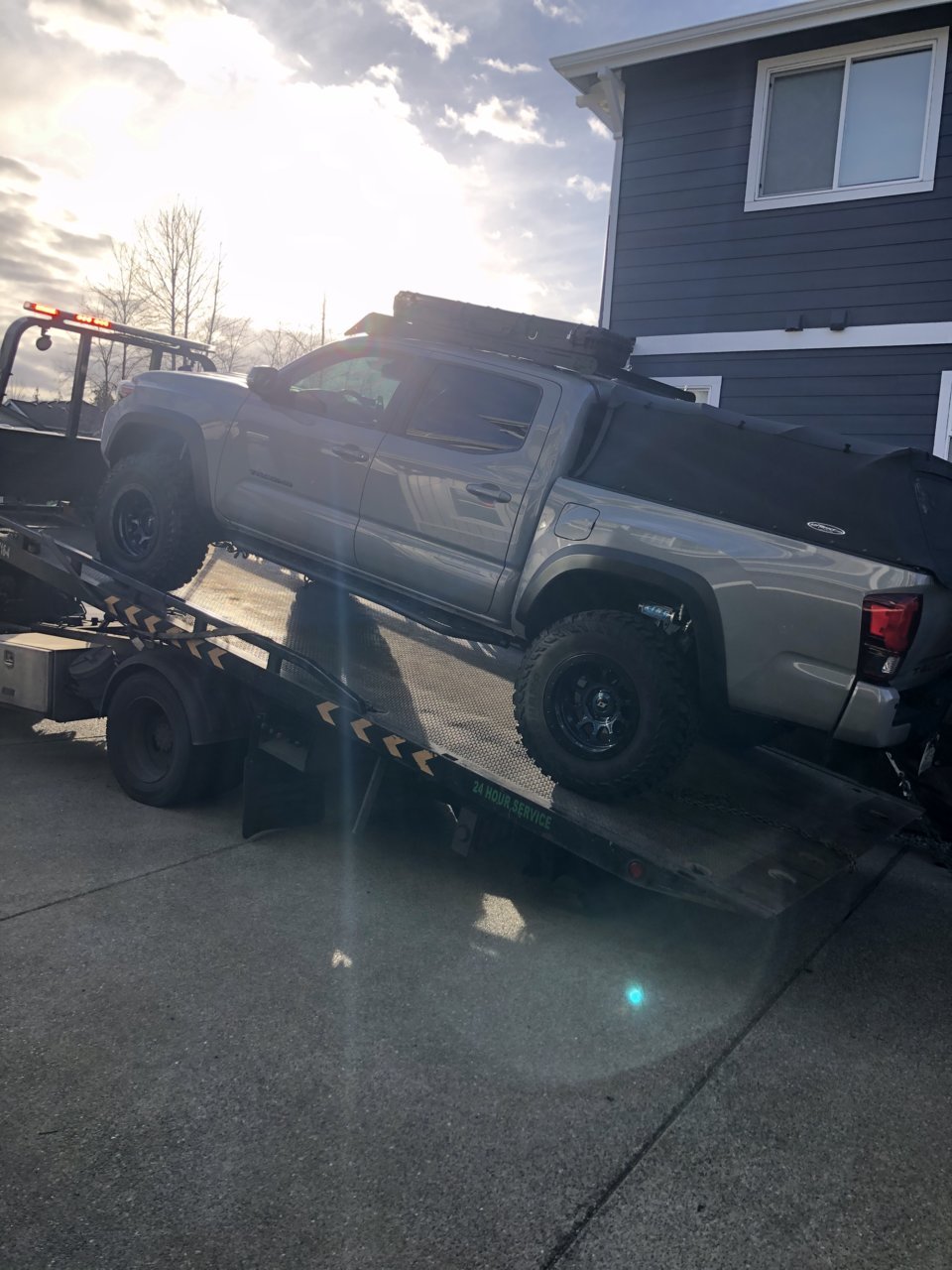

    I actually just ordered the double A version - got the two pack and will try and test them out whenever my truck is fixed -- appreciate the heads up.
    Have you found that they've helped you?
