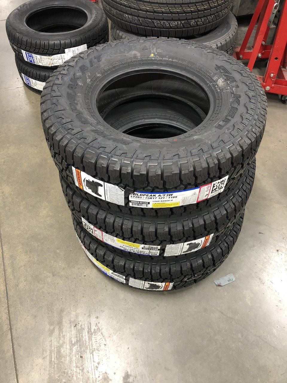

    F6774115-B31F-4BC1-A9A0-14ADA14EEAF0.jpg 514CF5B5-8296-40A3-AEA0-079ABC53F0AD.jpg 02CBF462-43C8-4612-8BDA-ED9F3FED47A0.jpg F6774115-B31F-4BC1-A9A0-14ADA14EEAF0.jpg Test fit just the front today after work.. deft tight, swung the steering and didn’t want to drive it out of the stall haha. Talked to Tyler at Pelfreybilt today, that guy is awesome, super knowledgeable and answered a ton of questions, even gave me some alignment numbers to shoot for. He’s sure after some work they’ll clear fine so I’m going to go for it.

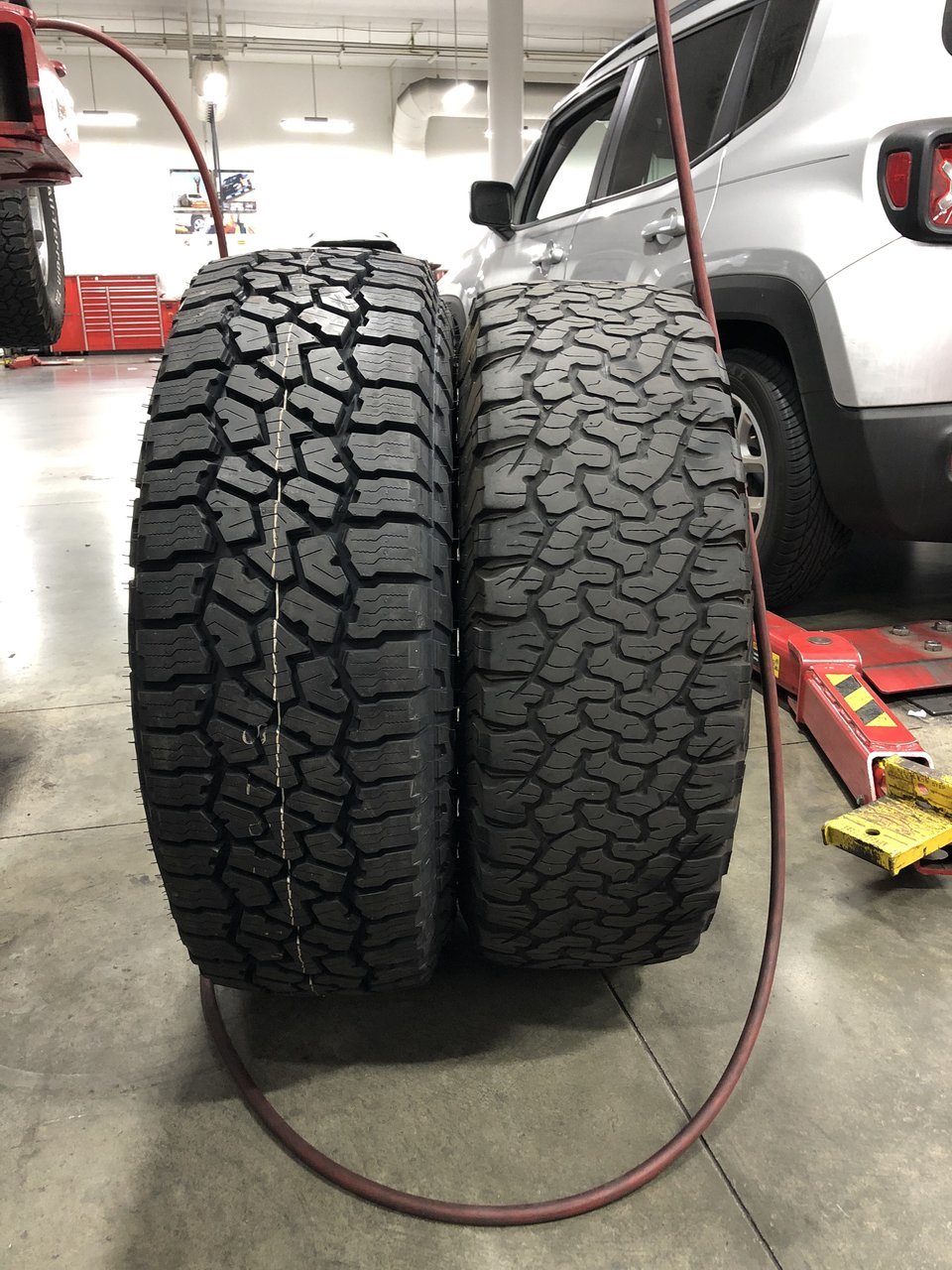

    0D6F875C-20B6-48A1-B5CC-1E12A5C219FF.jpg For reference, compared my 285/75/16’s next to it, they’re pretty toast tho.

    Your profile says you have Icons, are they installed in this picture? Any UCA's? How does/did the cab mount look?
    I'm curious what work you think is going to be required to clear these, and what Tyler told you. I'm going to find out soon enough and I'll post back here with info but it sounds like you are going to beat me on the install. Regardless, I'm committed so I'm going to make them fit lol.

    Yeah I have icon uppers and shocks, they’re on there in the picture but since they’re black you can’t really see any of it lol. Tyler told me BMC, pinch weld smash, and inner fender removal, possibly cutting more of the flare too. Also to try and see if I can get +3-4 degrees of caster angle. They deft hit the cab mount with a 45 degree turn of the wheel, I’m set to go next week to have the BMC and the rest of the work done then I’ll put the tires on and go from there.
