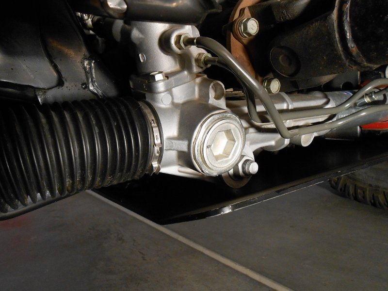

    DesertRatliff

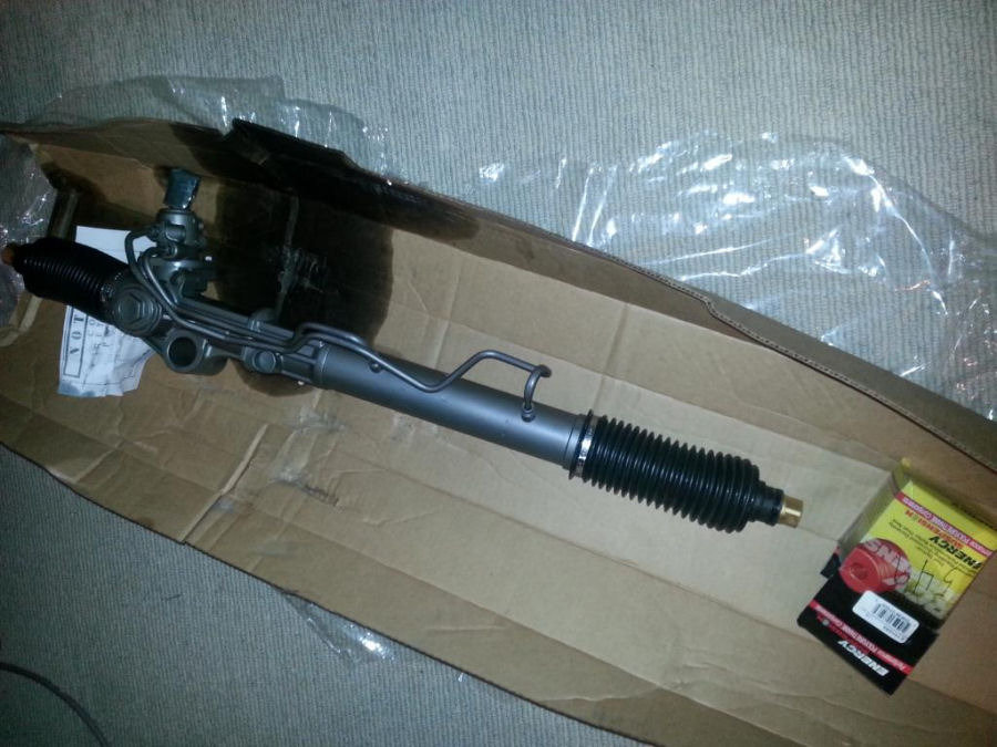

    Just swapped mine out with an A1 Cardone brand new rack and put the poly bushings as well the other weekend. Time will tell. Haven't felt this good of steering in my truck in years.
