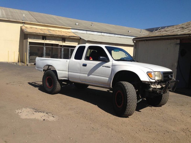

    Third one was a 98 4x4 Manual v6 with E-Locking Differntial. Had the awesome Lavender Steel color too. Miss this truck.
    Ended up with a Canti-lever Rear Long Travel, Mid-Travel Front End, 01-04 Conversion, 33's and custom bumper.

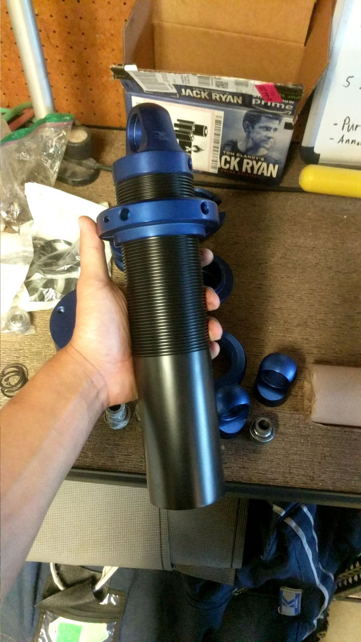

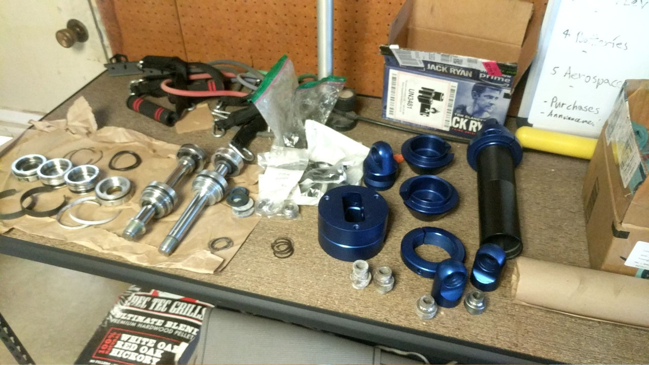

    Front was redone with custom anodized/cerakote King Coilovers, Camburg UCA's, Total Chaos Spindle Gussets, and Tundra BBK. Also, changed the front to manual hubs; kind of up in the air if this was a good idea or not.. time will tell.

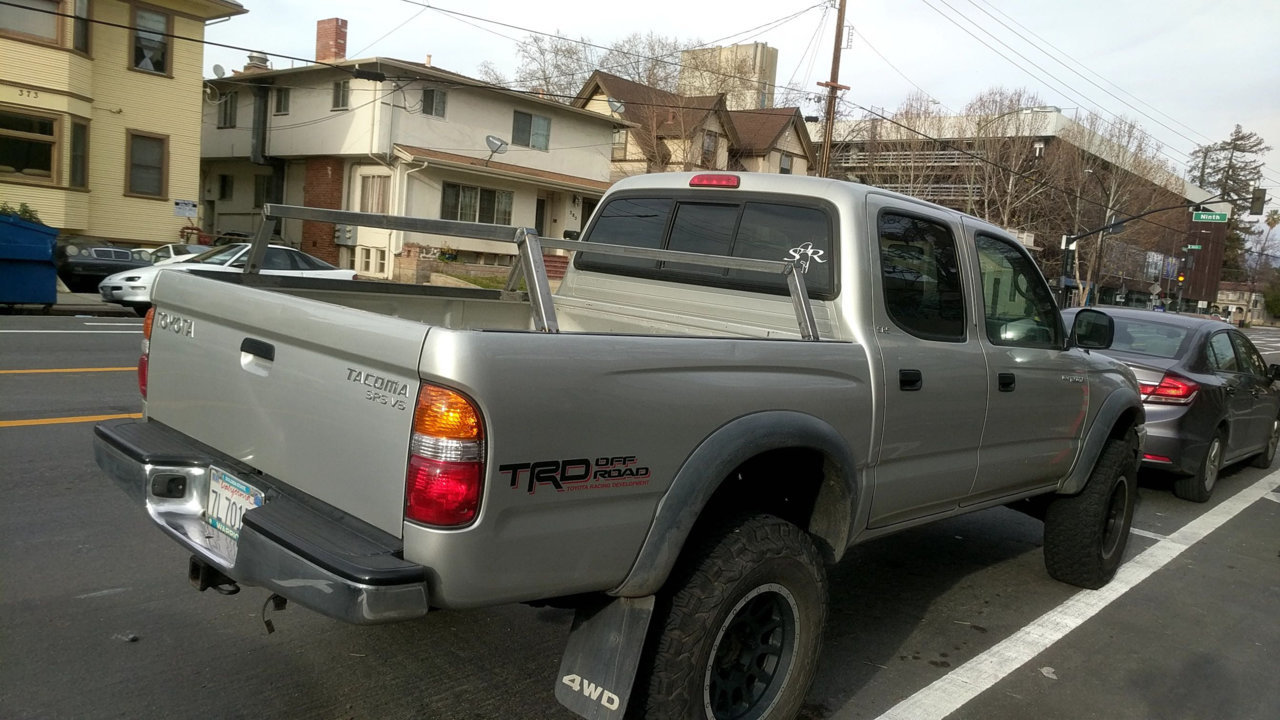

    Ended up buying a second-hand RTT and built a basic rack for the truck. I designed it so that the RTT say below the roof line of the truck.

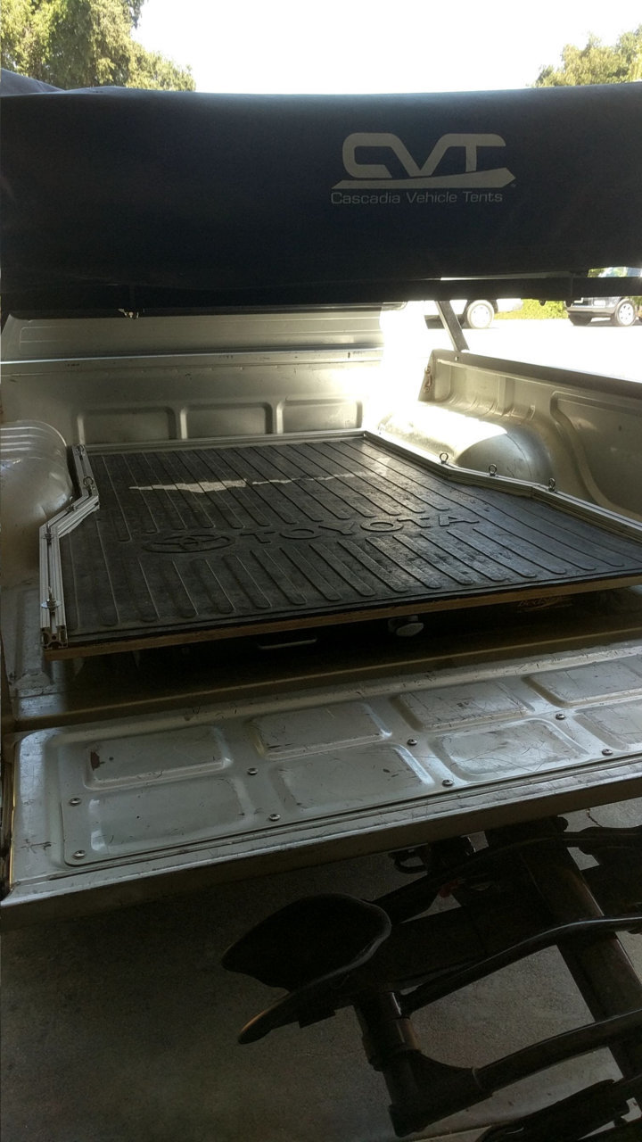

    At the same time retrofit a bed slide from a tundra and redid the top wooden portion.

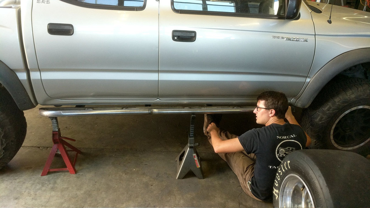

    Finally got around to welding on my BAMF sliders. Had these sitting in my garage for almost a year. Worth the wait and love the way they look.

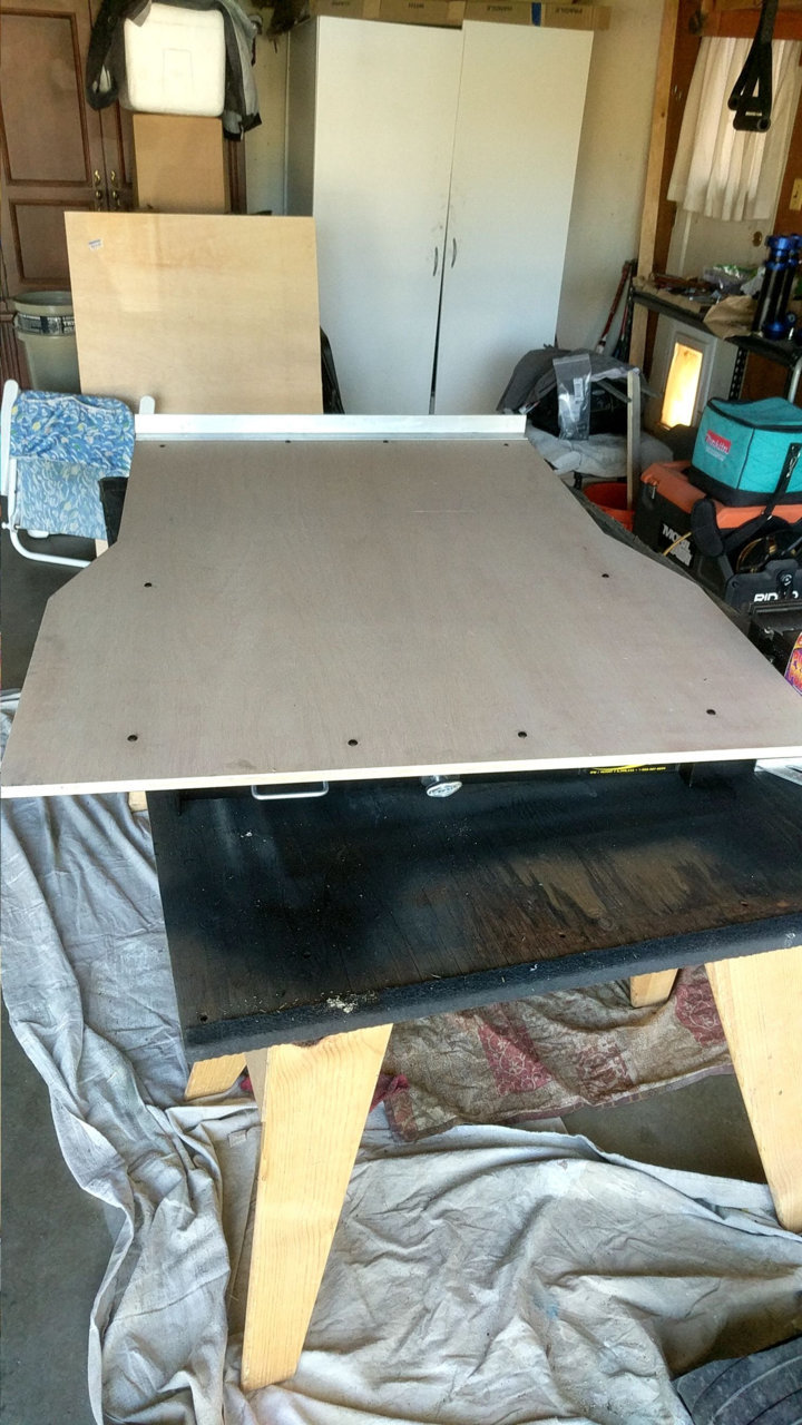

    Started working in CAD and came up with this.
    This has a sliding bed platform, side doors that open, and a rough idea for a cabinet system with bed fridge slide/drop down.
    Started the build off by cutting and notching tubes. Used 3D printed jigs to hold everything in place for tack welding.
    Here's a photo with all the gussets in place and the sliding bed platform.
    The steel is all 1.5" square/round tubing 0.65 wall.
    The bed platform is 1.25" 3/16 thick 6061.
