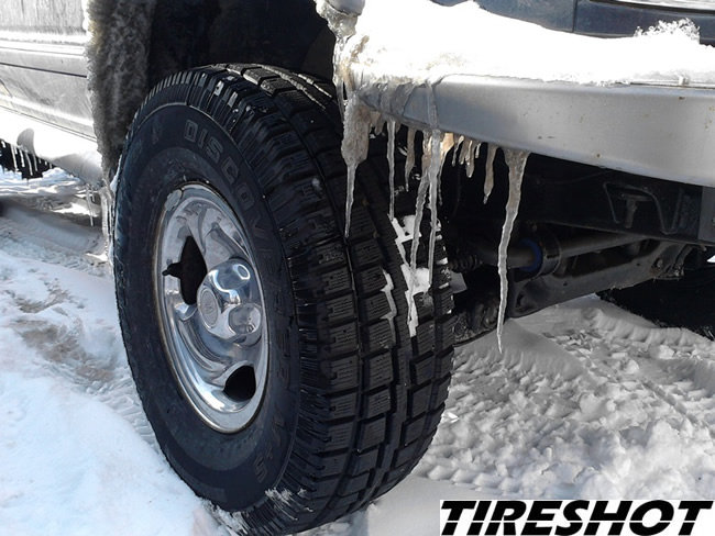

    I know you want to go with one tire year round but in your climate I think that’s a bit crazy knowing what you’re sacrificing. But if you insist on one, I just ordered some non studded Cooper M+S to mount up for the winter. I’ve read quite a few reviews of people running them as year rounders. They are SL rated and 39lbs with 15/32” tread depth.
    Random picture.

    Slid these on today. Probably won’t match up to Blizzaks or new premium snow tires but I think they’ll far outdoo them in the deep soupy stuff or off-road. $515 otd installed with certificates from discount. And a $50 rebate card coming in the mail. Only ran around town but seem so much smoother and quieter than the Duratracs.
