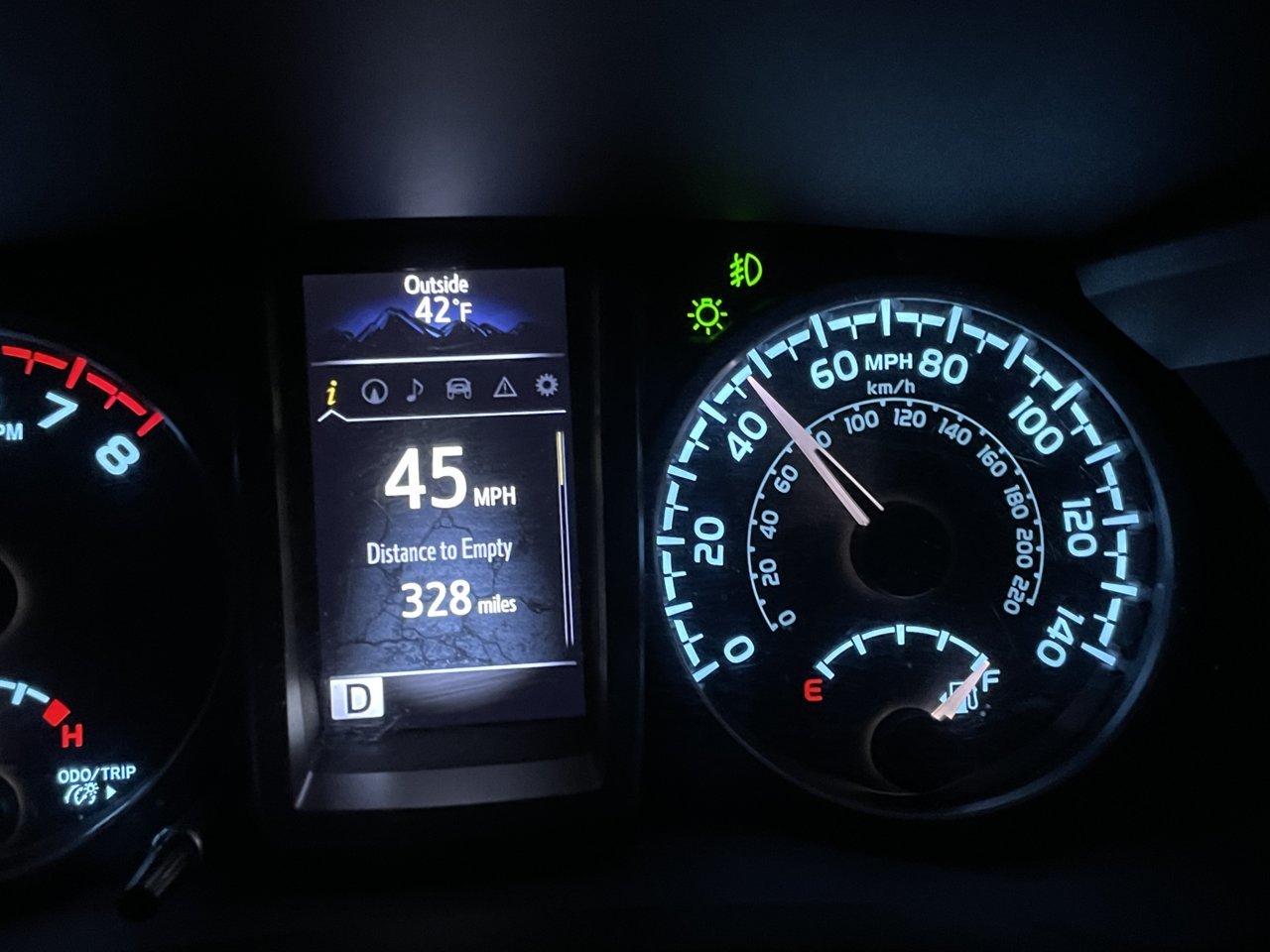

    Has anyone had this problem? Seems that it’s always off about 2 mph from the digital display. I don’t know which is correct, but does anyone know how to fix this or have any tips? Bugs the heck out of me

    Mine is the same, +2 on analog. According to GPS, the digital is correct. There are a couple threads on this already, no resolution last time I searched them.

    Change the screen.
    There always off a tad...
    How many read outs do you need ?
    lol
    it’s a do dad..
    Like outside temp
    You walk outside and the vehicle has frost on it ,,,it’s cold
    You walk outside and it’s snowing, there a chance of ice on the road..
    lol
    just busting ya..
    most times they read on the high side from the factory.
    Have had a lot of inquiries on this myself and there is no
    Fix...

    My '21 TRD OR AC 6AT is off about the same. Cruise control set at 68 and digital reads 67 on the flats. None of it I consider to be critical and I'm not going to fixate on it. It just doesn't matter much in the big picture.

    Dealer was able to fix mine.
    TSB is BND-SPDO-NDL1

    I had this same thought but I assume the stepper motor that drives the needle has a zero position each time it's powered on. I don't know that, just assume. In either case, I really want to pull out the cluster and see how it works to find out for myself if a simple "adjustment" would make any difference.

    My truck is also about +2 on the Analog

    My 2017 needle was off by +1 MPH when compared to the digital display. My 2020 is dead nuts on. Luck of the draw it seems.

    The digital one is based of the radios GPS, the one on the dash is based off sensors in the truck. So trust the digital one.

    Wait, this is the first time I have seen this. If that was the case the digital Speedo would be correct regardless of tire size and would not need a speedo calibration device. Can anyone confirm where the digital speedometer gets its signal? @caribe makaira ?

    I know when you replace the radio with aftermarket, that screen goes away. That leads me to believe its tied to the trucks GPS.

    Yeah, I’m fairly certain that is a can-bus issue and not a speedo gets it’s signal from the GPS in the radio issue. Happens in tons of vehicles since the early 2000s. A lot of important vehicle control systems run through the radio. Also why you can control several vehicle systems (locks, lighting, etc.) through the radio.
    You may be right but like I said, this is the first time I’ve seen that statement made regarding the Tacoma and it makes very little sense given the need for a speedo calibration (for the digital speedo as well as analog).
