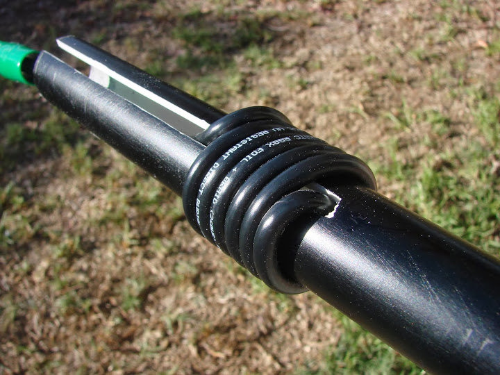

    I decided to educate myself on antenna design and theory. As it turns out, I did not know that end-fed verticals with ground plane radials need great care to function correctly. It's really true of all ground plane antennas. Anyways, I took my base station antenna down and made some changes.
    1. Insulate radials from metal mast using 2' section of PVC pipe.
    2. Added an RF choke coil to stop any common mode currents
    3. Reduced the size of the Larsen BSA bracket by cutting it in half.
    4. Switched to zip ties instead of hose clamps for mounting.
    5. Painted things black
    I cut the PVC pipe and made a RF choke coil.

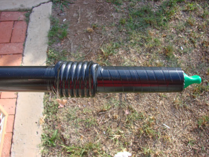

    All taped up

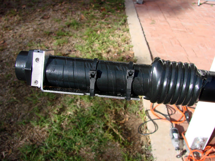

    BSA kit mounted with zip ties.

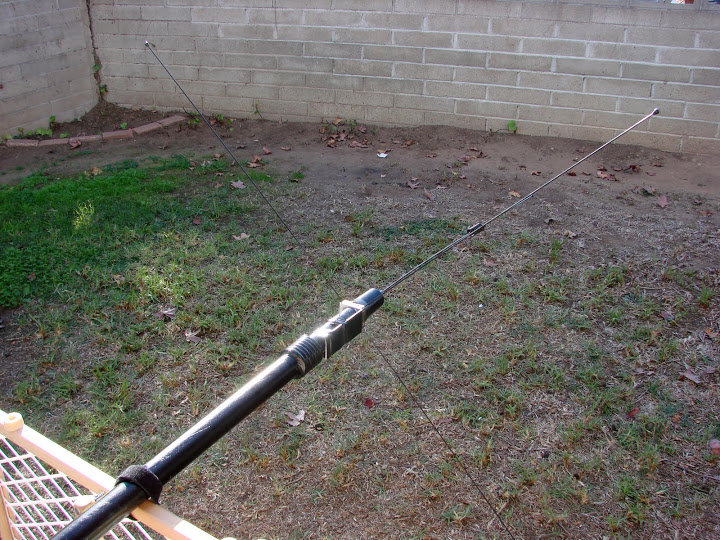

    NMO cap removed and antenna mounted.

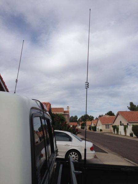

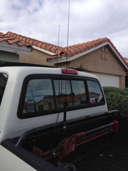

    Picked up a new Diamond 770 Antenna. Mounted to the bed bar and run into the cab to my radio.
    The old comet mag mount will be used with my HT for APRS.
