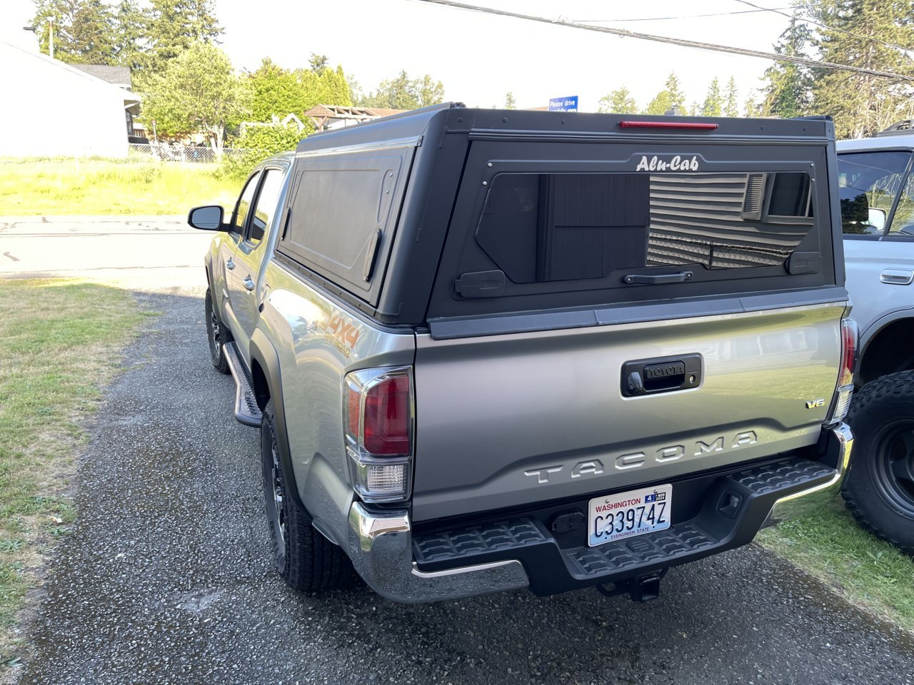

    Prior to installing my canopy I prepped the top of the bed rails by sealing them off with some thin rubber tape. Then I made small starter holes for the bed rail caps to feed through. I compiled what I thought were some of the best bed prep ideas that I could find. The Go Fast Campers sight had a forum section that was helpful. And although I filled in the leading edge gaps with butyl tape, I guess it interfered with the canopy mounting. So, MULE replaced my butyl tape with some of their sealant and we called it good. I didn’t get crazy trying to seal up near the tailgate or anything.
    I feel that a combination of the little prep I did and the positive pressure vent might have helped greatly in reducing dirt and dust in the bed. There was a little around the unsealed tailgate area, but even that was fairly minimal.
    Later when I was washing my vehicle, I didn’t really see much in the way of water making’s it’s way into the bed area. I also posted in the other RSI vs RLD vs Alu-Cab post in this section if you want to see more pictures.
    I just got it so I have only my first impressions to offer. I like it though. It definitely is one of the nicer options out there. It was either this or the GFC canopy topper for me. Some advantages are that with the Alu-Cab there is just enough space between the rear window and the canopy window to get your hand in there to clean the windows. I don’t think it would be happening with a GFC.

    @Road Bull thanks for all that info. I appreciate all the photos and it looks nice. I think I'm already convinced at this point to go with the contour canopy. I may start contacting suppliers to find out what the lead times are. Kinda interesting because I was debating about the GFC topper as well. Curious... did you install the latch covers yourself or can you get it delivered / installed with them?

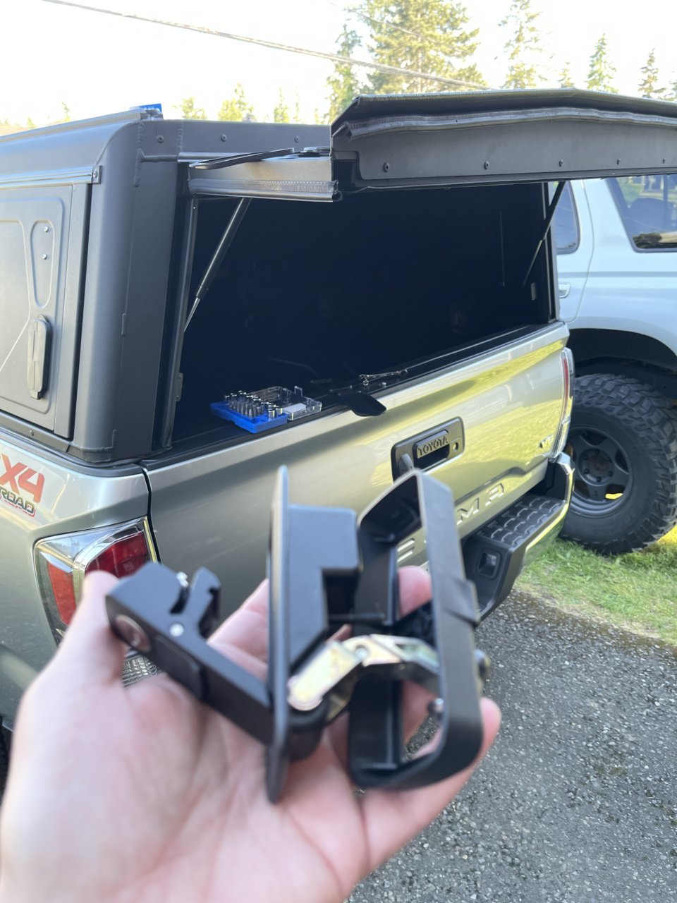

    It was a last minute add on at the store after it was out of the install bay. It is dummy simple to install and takes zero effort, so I didn’t mind.
    It’s only one bolt on the back side. You remove the bolt, take off the backing cover, push the latch mechanism through the front to remove it completely, orient the silicone cover on the outside with the leading endows fixing the top of the canopy on the sides, and facing the center on the rear hatch. Be careful tightening the locking nut on the backing plate. I could see it being easy to crack those if you crank on it too much. Applying some dry lube to the locks themselves helps out locking and unlocking them.IMG_1517.jpgIMG_1518.jpgIMG_1520.jpgIMG_1521.jpgIMG_1522.jpgIMG_1523.jpg
