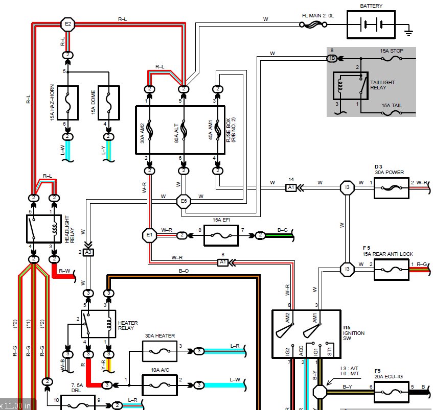

    there's a black and white wire also, where does it go from the fuse box?

    Two wires power most stuff.....
    Am2 runs the mainly the coil........
    thats the white/red wire....
    Other branch (red/w line) is power for a number of things...
    Heater/headlite/brake lite relays, and turns into the am1 branch at fuse box sending power to ignition switch- fuel pump - dash, ect...this one is pure white when it exits the engine fuse box.....red in.....
