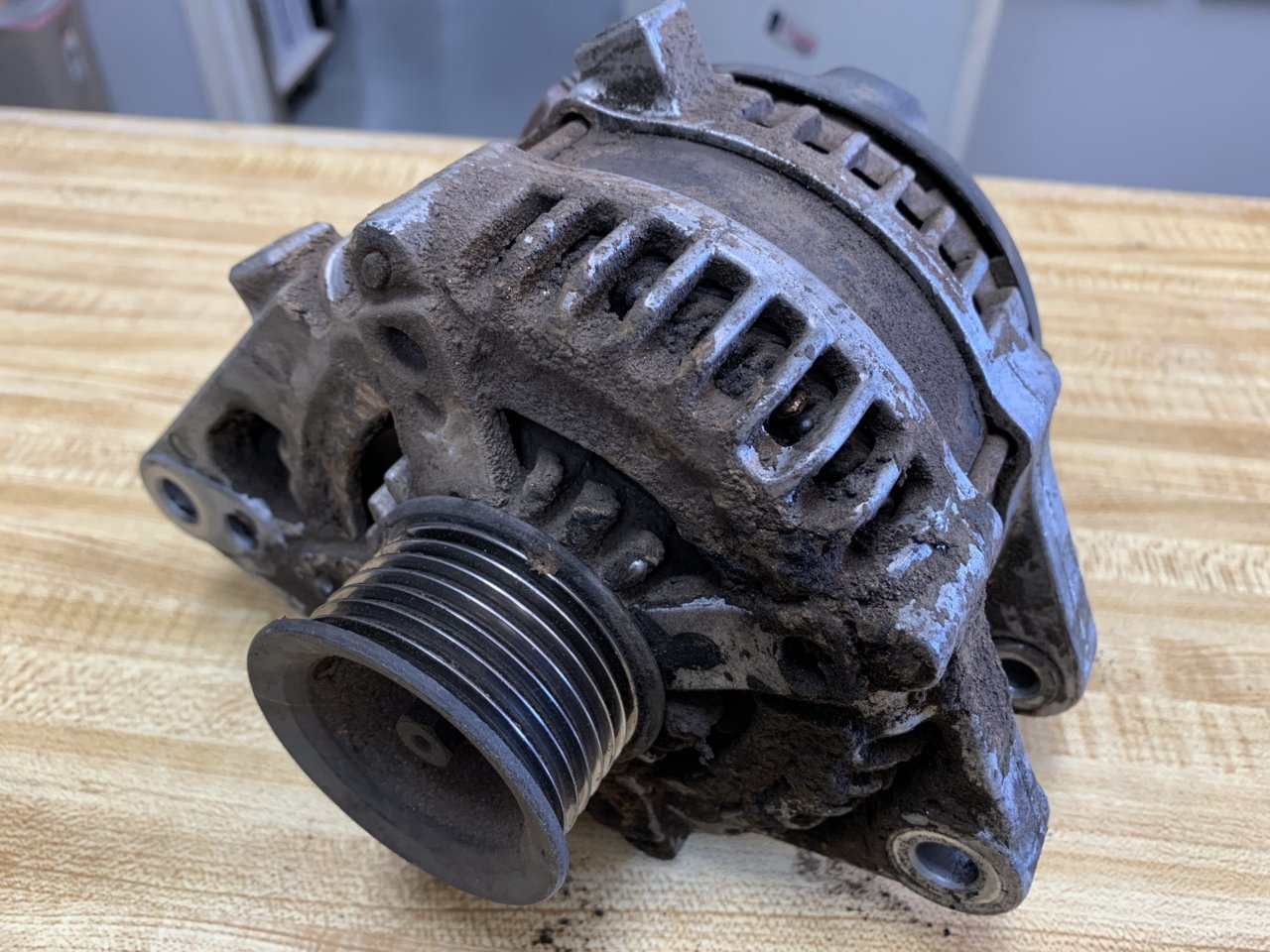

    Out with the old, in with the reman. Good to go now. Thanks for the input everyone!

    Yuck. Is that all oil and dirt?
    Not quite the worst one I've seen. When the bearings come apart and the shaft goes sideways and then it catches fire, apparently they don't take it as a core anymore :laughing:
