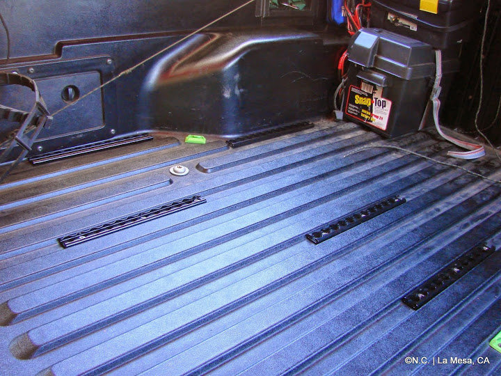

    Here is a mini dump of pics from my build thread. Hopefully it helps you.
    Drill some holes in the bed and lay down some l-track.
    They are mounted between the ribs of the truck bed. They are almost flush with the adjacent ribs, it's about 90% flush. I I had everything bolted in, I put back the bed mat and cut it. I strategically thought this out and I wanted 12" sections of the L-Track. For each 12" section there are three mounting bolts. I used all stainless hardware, 3/4" flat head machine screws, nylon luck nuts and 1+1/4" fender washers.
    Here it is with the bed mat put back and holes cut, My 4.5 year old daughter helped me every step of the way.
    I store the cargo fittings in the back of the truck until they're needed and move them. So easy.
    I mounted some L-Track to the front of the bed, for this I had to use special rivnuts for plastics.
    Hole pattern transferred and drilled:
    I held the nuts with a wrench from below and my wonderful helpful wife turned the screws with a ratchet. I used a bit of silicone under the track to form a gasket, as I didn't want any dust or debris between track and truck bed.
    Test fitting one of our camping totes.
    Nothing moves; ever.

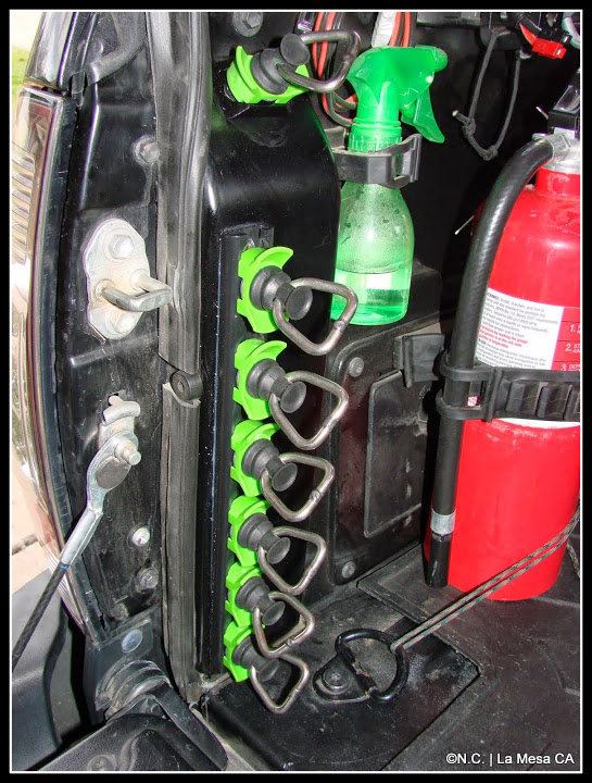

    I hate the proprietary c-channel that Toyota uses. If I had more time I would pull it all out and replace it with heavy duty l-track.
    But this works too. Eye-bolts.
    In Jan 2013 I needed some reliable tie down points and decided to put some eye bolts in the Tacoma rail system.
    I used some Grizzly G9513 - T-Slot Nuts, pk. of 4, 9/16" Slot, 3/8" - 16 for the proprietary Toyota track. I found some 3/16 x1/2" eye bolts at local home depot and grade 8 washers. They have served me really well when I needed to tie off a load.
    Over time I figured out optimal places for the eye bolts and I have not had to move them in a few years.
