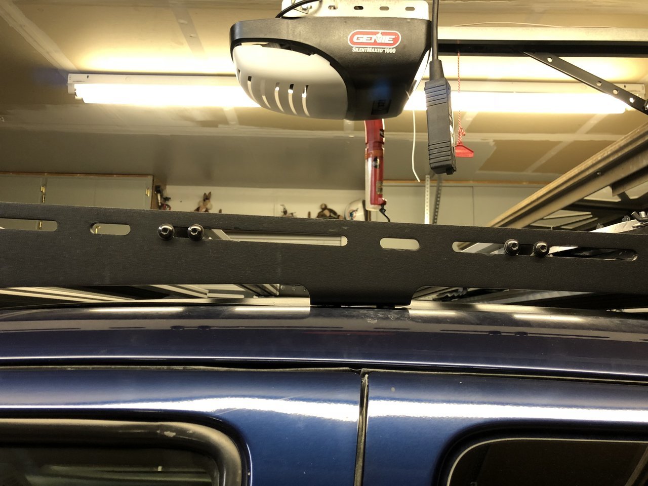

    Sorry for the delay on getting the picture:
    And you see here I put 4 on each side:

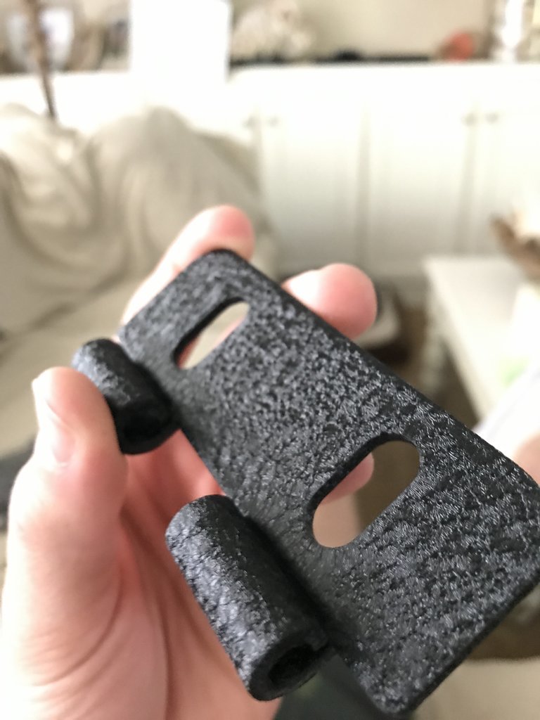

    Not sure where to ask this but has anyone shaved down the spacers in between the actual rack feet, and the roof of the car. The reason is I ask is I have a noticeable gap, and I think it would look and cut wind a little better with it soaked up to the cab closer. Just curious if its been done.

    I think it is in the main Prinsu thread, but there are a few links at the bottom to different spacers with different heights.

    Thanks! I just shaved them down
