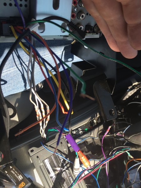

    I am looking this over and cant seem to figure it out. What do I do with the yellow and black wires coming from the alpine amp? Do I splice them with the HU harness or the vehicle side? What do I do with the unused wires coming off the HU harness? Confused.

    Manual????... Yellow 12vt and black ground

    Im trying to go for a 2 channel setup to livin up the front. For the life of me I cant figure out what to do with Acc, constant, and ground wires coming off the H/U and the factory/speaker side. I got a constant and ground coming off the amp and am not sure where they go?? Im trying to prevent running the constant to the battery as others havent had to. Any thoughts??

    I mounted mine couple years back but basically amp power and ground not hooked up to HU. Your HU speakers wires go to amp input then output from amp go to speakers . Forgot were I powering amp but power from battery or source that turns on when key on in accessory for amp power and ground to good chassis ground ( need 15 amp fuse at amp power )

    i would wire it into the stereo harness. black for ground. and i believe gray is the ignition switch controlled. i'd use that one. blue/yellow is constant one which is used for stereo memory.
