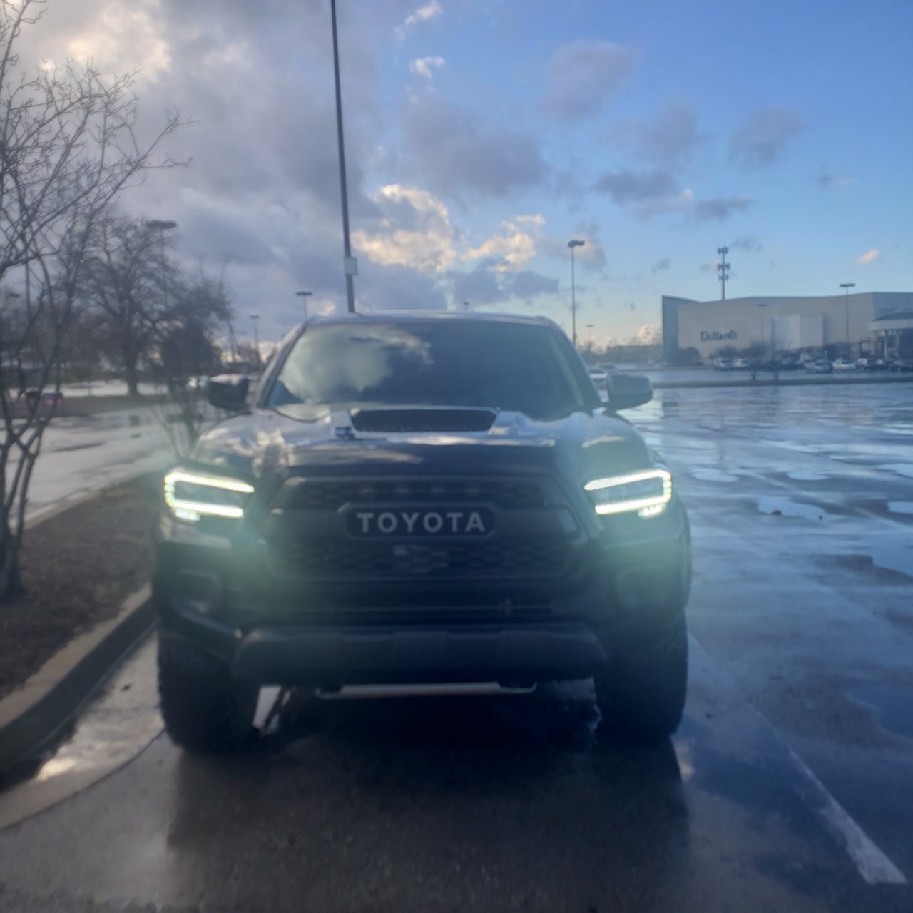

    No idea what they’re talking about. Bought mine. Best purchase I ever made. So much brighter than stock garbage. CA8F901F-F9CD-43F2-AB64-D5185706AB02.jpg

    Lol brighter. Brighter means nothing, it's all about how far the light goes. Read the links above. There have been numerous real tests conducted to show which headlights are shit (yours) and which ones work best (OEM). But, if you are going strictly for looks, your look good, they just don't work good.

    Yes, they are brighter, immediately in front of the truck with foreground light where headlights are supposed to have minimal light intensity output. They are significantly less bright at the top of the pattern in distance light, where headlights are supposed to have peak intensity output, to see distance. Super bright foreground light isn’t helpful, it is harmful. You don’t need to see 30’ in front of your truck driving at 60 mph, you need to see distance. And having super bright foreground light causes your pupils to constrict, further reducing your night distance vision. Even worse it draws your visual attention down from the headlight horizon to the short range light causing you to not focus where you should be for night driving. The entire pattern is literally backward and not a legitimate headlight pattern, and not from a credible manufacturer. But to compound things even more, people visually judge light output based on light closest to them, aka foreground light. So you end up with people on the internet not understanding automotive lighting design saying these lights are great, for all the reasons of why they are actually so terrible. And thus garbage products thrive.

    I get from point A to point B able to see very clear ahead of me. Don’t matter to me what you think. We got different opinions :)c
