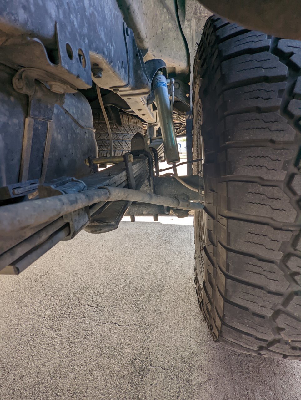

    na8rboy
    na8rboy 18 DCLB Sport Cement

    Yes you can. I'm on 6112/5160 with a 3-leaf AAL. Overall I'm raised up just a hair over one inch, front clips are on center setting (6 position shock, I'm on positions 3/4). I think I've spammed one too many threads on why I'm happy with them. :cookiemonster::cookiemonster:
    Depending on your goals you can easily recreate stock height with that combo.

    You asked, so here is my honest review on the 6112s. I keep saying that they are the Sport suspension on steroids. They are stiff as hell on the road, and they kinda, sorta loosen up off road. I'd sum it up as a fantastic highway suspension that's pretty good on trails. And that's what swayed me to buy into it: most of my highway use is either commuting or pulling the camper somewhere, and I might be poking along on light to medium trails on the weekends. So I wanted something that leaned towards pavement performance.
    On road, they are sporty as hell. Smooth on the straights and they stiffen up in the turns. There is no wallowing, hobby horse type action that most offroad suspensions suffer from. And as stiff as they are, they don't ride like an empty dump truck. It's a smooth ride, pliant in the right places and planted when it should be.
    Off-road they are no slouch either. These things are beefy for the money. Unlike the stock suspension they don't get hot or show signs of fade. I just got back from a trip that included 50 miles of nasty washboard, and the shocks behaved the exact same from the beginning of the trail to the end, and then again when I drove back out a few days later.
    The biggest characteristic that impressed me is their rebound/dampening ability. For a budget-to-mid-tier shock, the rebound is supreme. It takes the hit and immediately plants the tire back to ground without any chatter or bounce. It makes for confident driving.
    On the downside, rough trails are rough. I went through a little bit of a rock garden on my previously mentioned trip, and it was slow crawling. To be fair I still have my sway bar on and my lack of flex was a definite contributor to it being less than comfortable. It was still doable, but I imagine that a more off-road geared setup could have done it smoother.
    But overall, it's a good compromise in all the right places where I want compromise. It isn't too expensive, excellent on road, good on trails, and merely adequate for hard terrain. And the ride height, where I have them set isn't bad either. Definitely a good bang-for-buck value.
