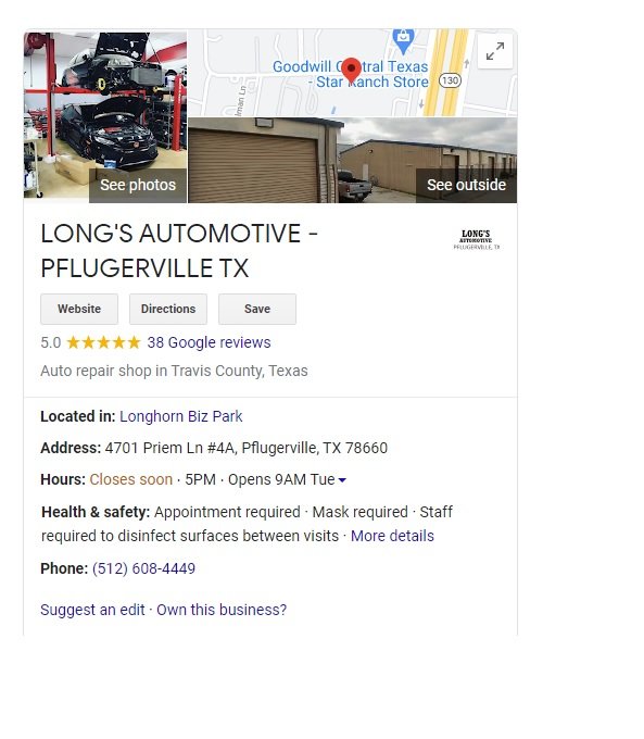

    call my friend
    https://longsautotx.com/
    Ive seen them do plenty of lifted Jeeps there (since one of the mechanic is a Jeep guy)
    They do great work there too. Read their reviews. Tell them Paul sent you
    Funny, my profile pic is my truck getting aligned there. But Im stock height so call first to make sure
