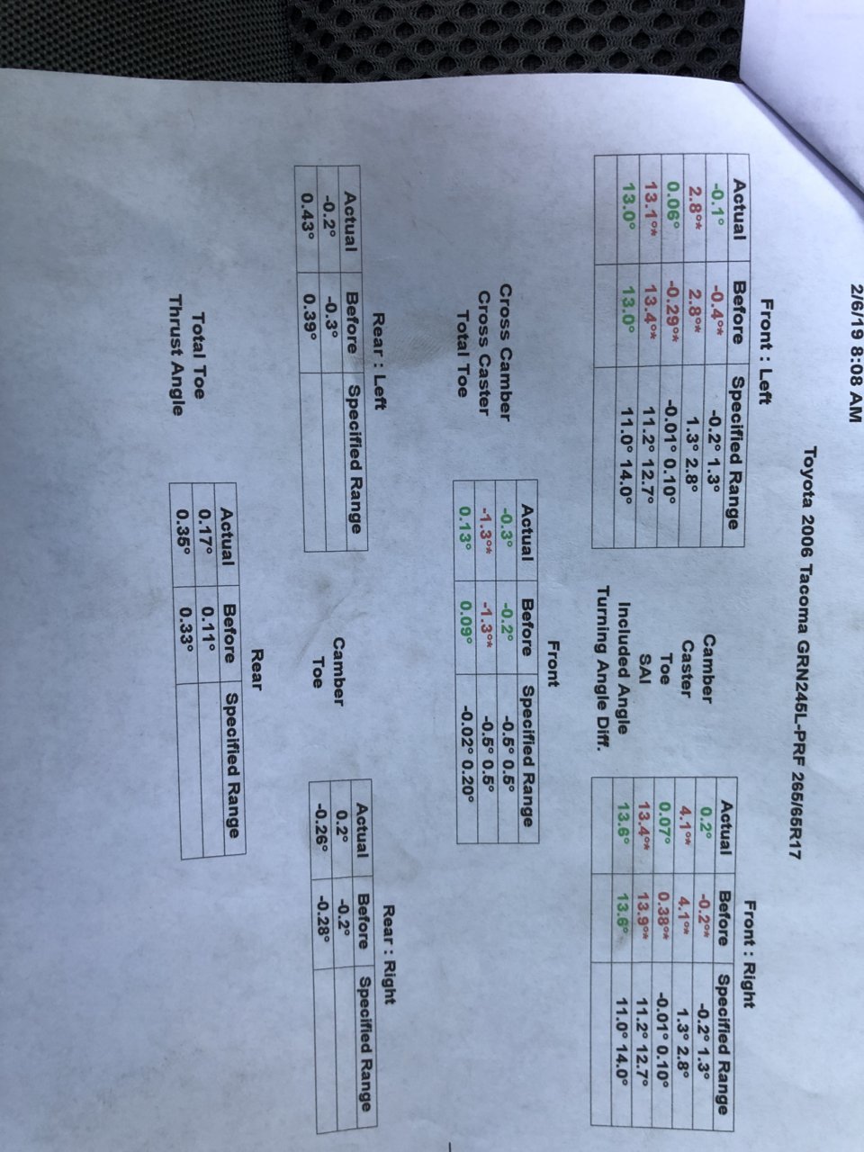

    Has anybody had alignment shops give them problems with aligning the steering wheel straight?
    I went back twice, and the 2nd time the owner took it for a drive with me and said that it's as good as it's going to get. He told me it's because of my lift and that the settings were all maxed out. I also have a bad wheel bearing and they said that could also be the reason.
    Should I accept this?

    How about you post up an alignment printout.

    The only reason that the steering could not be set straight would be if someone had the steering intermediate shaft apart and put it together a few splines off and then when the shop aligned it, the threads bottomed out on 1 of the tie rods. Look at the tie rods. If there are at least a few threads showing on both sides, they are full of crap.
    While I was typing this, you posted the printout. They're fuckin idiots!!!!

    that tech sucks by the looks of your numbers

    Here's the facts to back up my opinion that they're fuckin idiots. They made no effort to correct the gross difference in caster between sides. They changed the camber .3 on the left and .4 on the right without affecting the caster even .1 of a degree. That's damn near impossible to do.

    Do those numbers look good for the tires? I am starting to not even care anymore. I am not willing to put any more money into my truck. I just put a set of new BFG AT KO2 265/75/16 and just want them to wear evenly.
