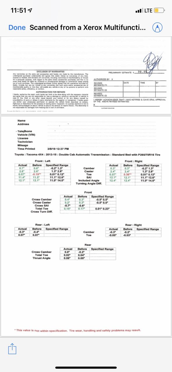

    EF4F969B-8B81-4447-A4C9-356B0E85A5AE.jpg Latest alignment after new tires. Actually this is the 2nd alignment after new tires. 5th alignment in less than two weeks.
    Tires were put on yesterday. Alignment done. I drive it around the block, now pulling to the right and steering wheel not center. Took it back to them.
    They realigned today. Steering wheel still crooked, pulls to the right. The steering wheel actually centers itself and then car goes to the right.
    Losing my patience with these guys.
    Any thoughts? Sales manager is calling DSI, who he says specializes in lift kids or Offroad upgrades. Maybe something is loose or more than alignment needs to be checked

    The toe and camber are within specs but could be much better. I'd take it to a different shop that can dial it in.

    Alignment shop showed me lower control arm bolts are seized so the caster can’t be adjusted. He said that’s what’s causing the pull.
    Oof
    Now back to dealershit to see if they are going to pay to replace the LCA’s
    They’ll pay 50%. Don’t know what the estimate is yet.
    Are lower control arms part of a lift? I don’t think they are but if so then I could just wait and do it when I decide on a lift.
    As of right now it’s driving straight and the steering wheel is straight. Berts said he adjusted the toe to reduce some tire wear that will be caused by the unadjustable LCAs.
